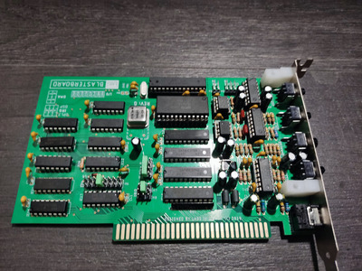

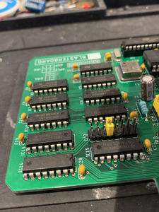

Reply 523 of 555, by pan069
Hi everyone, quick question.
I was wondering if anyone had QA issues with their pre-made Blasterboard? I had one ordered and pre-made about 2 years ago and it stopped working, I wanted to used it on my NuXT Turbo XT as it seemed a perfect fit for it, and I noticed quite a bit of rust on the legs of some chips.
If I compare the chip legs of the Blasterboard they look dull and rusty/flaky in places compared with my ~30 year old SoundBlaster CT1350 where the chip legs look clean and shiny. I was wondering what could be the cause of this? Chip quality?
Thanks!

Reply 524 of 555, by LABS
Hi, sorry to hear about your issues.
Are you completely sure nothing was spilled on it?
IC13 and IC14 are rusty indeed, but IC15 is fine (the same 74HC138 chip).
And that IC12 - very strange.
Please pm, will try to figure out why it stopped working.

Reply 525 of 555, by pan069
LABS wrote on 2022-12-29, 08:32:
Hi, sorry to hear about your issues. Are you completely sure nothing was spilled on it? IC13 and IC14 are rusty indeed, but IC15 […]
Hi, thanks, I'll send a DM. I remembered I posted a photo of my Blasterboard here on Vogons shortly after I received it. It shows IC2 with a bit of corrosion on some of the legs, unfortunatly, the other ICs are to fuzzy in the photo but I did take another top-down photo back then and there is some corrossion visible there as well. I'll send you the photo in a DM.
Re: BLASTERBOARD : A new SB 2.0-compatible ISA sound card
Edit: To answer your question, nothing was spliited on it. I'm very careful with my hardware.
Reply 526 of 555, by root42
The rust looks like what you would get on old C64 MOS branded logic ICs. Bad or no passivation layer on the legs. When did NXP stop making 74 series logic? Maybe they did some crappy ones? The latest datasheet is from 2015:
https://media.digikey.com/pdf/Data%20Sheets/N … HCT138_Rev5.pdf
And at Digikey they are listed as obsolete:
https://www.digikey.de/en/products/detail/nxp … 138N-652/763002
My guess is that this is a bad batch and/or rebranded NOS pieces, that are actually not NXP, but some inferior brand.

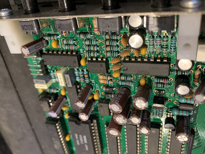

Reply 528 of 555, by root42
My board has TI chips exclusively. Some look a bit tarnished, but I have that with brand new Mouser TI chips as well. It's the passivation layer I think.

Reply 530 of 555, by LABS
Thanks, root and mjay
Please, if anyone else ordered an assembled card and has NXP 74HC138 chips in it, let me know if you have the same issue as pan069

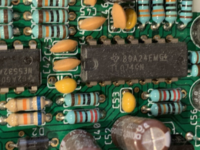

Reply 534 of 555, by rkurbatov
Yay! I did it.
I've got new YM3812 chips (nasty old ones actually) but that didn't help. So I started checking the nearest ICs. There was 74HCT245N that decouples 2 8-bit buses as I understand. It had some resistance between 7 bits from both sides but bit eight wasn't connected. I checked all chips from that supplier (I bought 5) - all were faulty. Will use my TL866 next time for everything before soldering.
Hour of curses (hate desoldering chips, I still ruin boards, wig doesn't help) and replacing the chip - and everything works!
Also I replaced TL074 op-amps with OPA4134. Name it clinical audiophilia, but I like result much more. The sound is more distinctive and punchy as for my taste, sounds less 'noisy' or 'digital' for OPL. Also, I ordered several YM3014 DACs (just in case) - it seems like older version of YM3014B provided in kit. I cannot measure the result but to me it sounds better - the high frequencies are less pronounced and percussions blend better. So if you assemble this card like me - use sockets not only for DSP, but also for opamps and, probably, for DAC, just to have possibility to compare the sound.
I'm happy. Will try to test it on something more powerful than 386 with MOD music, poor old 386/40 doesn't feel well playing 66kHz music and starts freezing with interpolated sound. But even what I managed to hear is pretty impressive. Anyway, very nice device. Having it assembled by myself, even with difficulties that I treat as quest, was so fun. If somebody wants to repeat - buy the assembled one or at least check the ICs you've ordered yourself with logic tester. Seems like TL866 is required by any retro-hobbyist just like soldering skills even if you are not going to become the radio-engineer. 😀

Reply 535 of 555, by LABS
Glad you made it, have fun! 😀
rkurbatov wrote on 2023-06-06, 20:15:
...Also I replaced TL074 op-amps with OPA4134...
It is nice that you experiment with the sound, OPA4134 is a good choice for this exact circuit without any modifications and it is not too expensive. Haven't seen them from any reliable supplier for a long time in DIP package though.
