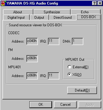

With the help of PCI.EXE for finding the PCI base address and PCISET to modify the correct registers I managed to get the YMF744 working on a motherboard that doesn't support legacy/ISA addressing over the PCI bus. This could also be useful when using the YMF744 behind a PCIe-PCI bridge. The registers you want to modify are 62-63h and set them to PCI base address +40 after the initialization of the card with SETUPDS.EXE.
Used this to set the Sound Blaster base address to DF40h (PCI base address is DF00). The FM synth of the card are aviable at PCI base address +60h.
(DF40h = 1101111101000000b)
pciset 0010 1073 63 11111111 11011111
pciset 0010 1073 62 11111111 01000000

This picture actually gave me the idea to try this out:
22.75 KiB
3601 views
This picture actually gave me the idea to try this out.
Edit: Tried Epic Pinball and One Must Fall 2097 with the REMAPCMI utility without success with both games crashing hard. Perhaps REMAPCMI and DSDMA don't like each other? Forgot that REMAPCMI remaps 220 to PCI base address +50h, when loading it with the YMF744 you need to subtract 10h from the base address to get base address +40h.
The games I had success with: Descent, Doom 1.9 (no FM bacause of hardcoded address) and Duke Nukem 3D (no FM bacause of hardcoded address).
