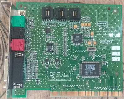

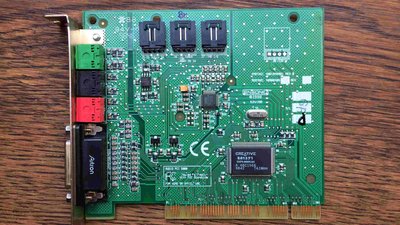

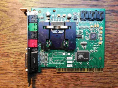

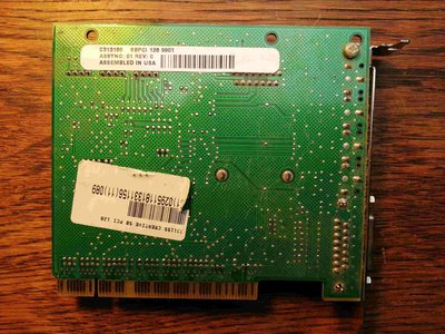

If I'm not mistaken, for the pure Win98 gaming a PCI soundcard would be appropriate. I have these PCI sound cards available:

Soundblaster AudioPCI ES1371 front

Soundblaster AudioPCI ES1371 back

Soundblaster PCI128 front

Soundblaster PCI128 back
Which one is better? Another option would be the Vibra16c from the ISA lot. But I would consider these PCI cards superior in sound quality and things like bus mastering. BTW, I will not connected it to passive speakers or headphones. I'll use a proper amplifier for it. So, the impressive amplifier chip on the SBPCI128 is of no use to me.
And a bit more background about my Windows gaming requirements: I'm mostly interested in mid to late 90's Windows games (POD, GPolice, ... hence the PPro 200 is enough for me). So no fancy 3D sound features are required, which these cards don't have anyway.

The 5507 is a relabeled ES1370. So basically your choice is between some or other Vibra (exact model is relevant, as it determines noise levels and which bugs are present), an ES1370 and an ES1371. Given the pure Windows focus, the ES1371 has the advantage of being fully AC'97 compliant. With the ES1370 some sound could play at the wrong pitch.
Bus mastering is pretty irrelevant for audio quality, so it's possible that the Vibra might beat the ES1371, but under Windows only the ES1371 is a safer bet.

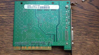

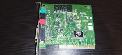

Hello, I have this Soundblaster PCI 64.
download/file.php?mode=view&id=182835
According to this thread, it should have relabeled ES1370 chip.
Different Versions of Ensoniq AudioPCI
To my suprise, HWInfo detected it as ES1371.
Now I've heard, that ES1370 is slightly better to have.
Can somebody confirm, if it is ES1370 or ES1371 based?
Because when I look how "ES1370" Audio PCI 3000 looks like, it's really 100% the same PCB, except the chip.
download/file.php?mode=view&id=182836

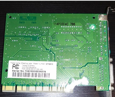

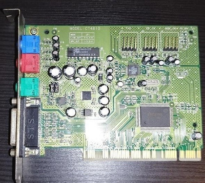

Now I have SoundBlaster Vibra 128 CT4810
download/file.php?mode=view&id=182843
download/file.php?mode=view&id=182844
according the list in vogons page, it should be: CT2518/CT5880 with Crystal CS4297A/SigmaTel STAC9721T and maybe TDA1517P amplifier
Is it ES1370 based or ES1371 based chip?
