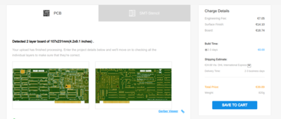

Reply 5 of 505, by root42
Holy crap, I am SO going to build this. But the component count on this one is really... massive! I think I am NOT going to provide kits for this. But if anyone wants to join in an order of PCBs from JLCPCB, I am all ears. 😉
YouTube and Bonus
Reply 6 of 505, by root42
10 PCBs with enig gold finish, chamfered edge connector will come out at roughly 40 EUR, plus 25 EUR shipping.
The attachment snark-jlc.png is no longer available
Any takers? I would personally want two PCBs. But other than that...
