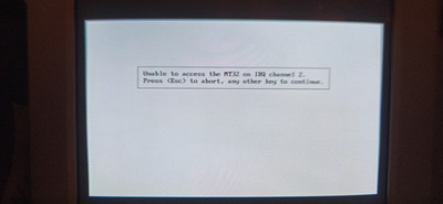

I am trying to get Spellcasting 101 to run with my MT-32 and keropi's PC MIDI card. It hangs after the warning and the logo screen. I see the Guitar patch flashing on the device, and that's it. Silence. Spellcasting 201 works just fine. Any ideas?

So I tried spellcasting 101 on my 386DX40 test system. It froze. 😵
Then I removed the PCMIDI and installed a SCC-1 I had nearby. It froze. 😵 😵
Both times after the warning, like root42 mentions above.

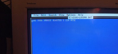

I tried to google and could only find a relevant post here: Re: MPU-401 Intelligent mode
puttesnutte wrote:
Congratulations! I can't even get David Wolf to play MT-32 music using a real MT-32 connected to a real Roland MPU-401 interface […]
Congratulations!
I can't even get David Wolf to play MT-32 music using a real MT-32 connected to a real Roland MPU-401 interface installed in my 486 DX2-66 running MS-DOS 6.22...
I don't know if these games use intelligent mode, but I had problems getting the following early Legend Entertainment games to work with the hardware mentioned above:
Spellcasting 101, 201 & 301
Gateway 1 & 2
Eric the Unready
TimeQuest
I think I changed some IRQ-setting on the 486's IO-card to get them to work. Most other games supporting the MT-32 had worked perfectly without having to change this.
And (as I mentioned somewhere else in the forum) all Sierra SCI0-games (King's Quest 4, Space Quest 3, Larry 2 & 3, Police Quest 2, Quest for Glory 1 & 2, Codename Iceman, Colonel's Bequest, King's Quest 1 Remake, Conquests of Camelot, Hoyle 1 & 2) fail to work with an MT-32 connected to the MIDI-port of a SoundBlaster. (there is a patch to fix this)
So we are not alone in this. Second result here: Spellcasting 101 CD + MT32 Fix
FeedingDragon wrote:
I was having problems getting the MT32 to work with Spellcasting 101, and found others with the same problem here. I didn't find a solution here (or on the web,) but in desperation (ok frustrated anger,) did some experimentation. I finally got it working, but the old threads were to old. So, for anyone interested here is the very easy fix.
Edit the Legend.bat file (or your config file if you are like me and bypass the bat file.) Remove the "2 330" part of the command line so that it reads (in my case,) "S101 SVGA XMOUSE BLASTER 7 220 MT32" and after a MT32 notice screen the game loads and plays MT32 just fine.
So there is a CD-ROM compilation that ALSO needs some tinkering to get it going. WTF Legend!?! 😵
I first tried the compilation on DOSBox, and it does indeed freeze if you don't remove "330 2" from LEGEND.BAT
Then I installed the games on my test 386DX , edited LEGEND.BAT and Spellcasting 101 finally worked! 😊
A simple comparison shows that the CD-ROM compilation uses a newer/fixed/unified/whatever-I-don't-care game engine at least for Spellcasting 101 that fixes all those mpu issues provided you edit LEGEND.BAT 🤣 🤣 🤣

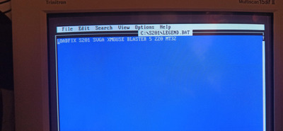

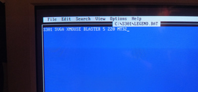

Reply 11 of 16, by Dimitris1980
Well, i haven't found solved the problem with Roland on these following Legend games:
S101
S201
S301
Companions of Xanth (floppy and cd)
Gateway 2
Spellcasting series are from the cd collection, all three games with install file and also a Roland MT32/CM 32L option for music.
I use Keropi's PC Midi card.
- Macintosh LC475, Powerbook 540c, Macintosh Performa 6116CD, Power Macintosh G3 Minitower (x2), Imac G3, Powermac G4 MDD, Powermac G5, Imac Mid 2007
- Cyrix 120
- Amiga 500, Amiga 1200
- Atari 1040 STF
- Roland MT32, CM64, CM500, SC55, SC88, Yamaha MU50
Reply 12 of 16, by keropi
for spellcasting trilogy CDROM, did you remove ""330 2" from LEGEND.BAT ?
🎵 🎧 PCMIDI MPU , OrpheusII , Action Rewind , Megacard , MK8330 and 🎶GoldLib soundcard website
Reply 13 of 16, by Dimitris1980
Yes, but no success.
