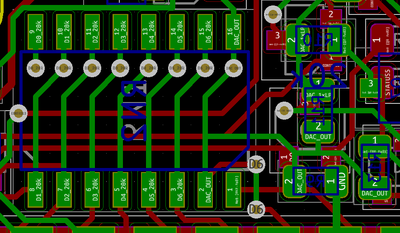

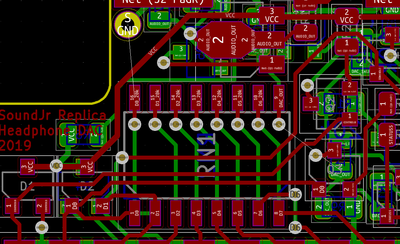

Change of scene: The SoundJr replica. It looks like I'm stuck again, because I cannot see through the resister packs. Everything else is complete.
113.42 KiB
2500 views
Those three traces that go beneath the resistor pack on the front layer have to go somewhere and I'm not quite sure where that is.
They start at pin 1 of Q2, Q3 and Q4, respectively.
Reply 44 of 93, by Benedikt
Not further than has already been done. One would have to probe around with a multimeter and find connections with near-zero resistance. So there's no need to get out the soldering iron.
Once that is sorted out, only the value of the filter capacitors remains unknown, but that can be determined via trial and error, i.e. by comparing the frequency response.

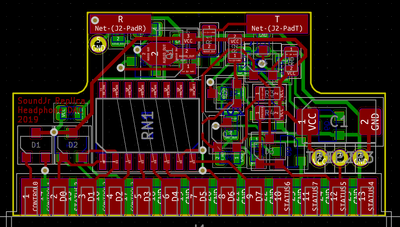

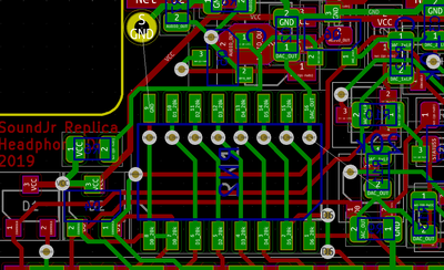

Reply 46 of 93, by Benedikt
Alright. There is some progress. The traces that go below the resistor array on the front side of the board have been figured out. (Thanks, Cloudschatze!)
But there is one such trace on the back side, as well. Where could that go? Does it really connect to DAC_OUT?
And normally, one would connect one side of an R-2R ladder to GND, but I cannot find any such trace.
It should also be noted that the wiring between RN1 and RN2 is entirely speculative.
I connected the upper row of pins on RN1 to the upper row of pins on RN2, because it would make sense, but I cannot verify that, either. Maybe it is shifted on the original board.

Reply 47 of 93, by Benedikt
And we are almost there!
Yes, it was shifted a bit and no, this particular R-2R circuit apparently does not connect one end to GND.
Only one question remains: Are the resistors next to RN2 connected to DAC_OUT or to the bottom row pin next to it, i.e. DAC_OUT via 10kΩ resistor?
77.83 KiB
2426 views
EDIT:
Cloudschatze wrote:
The circuit containing the resistors connects to the corner Pin 1, per your latest diagram.
Thanks! That means it is DAC_OUT via 10kΩ resistor.
(And it looks like my initial theory was mostly correct and we are indeed dealing with an 8+3 bit DAC. So forget my rambling about implicit volume control.)

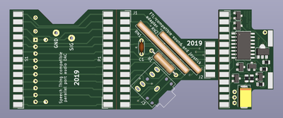

Reply 48 of 93, by Benedikt
And this is the 98mm×37mm PCB for production:
48.59 KiB
2404 views
Now we'll have to wait.

Reply 50 of 93, by Benedikt
Paralel wrote:
In the end it seems obvious that the SoundJr. would be a far better design to use for anyone that wants to build a covox/covox-like device since it can do everything a speech thing can do, plus more, as I originally surmised.
It is indeed clearly superior. Unfortunately, it will also have between three and four times the BOM cost and it will take about ten times as long to assemble it by hand, at least without special equipment.
I do however plan to do some component substitution to reduce the cost:
  • The Bourns 4816P-1-103LF / 4816P-1-203LF resistor packs are electrically and mechanically equivalent to those in the SoundJr and only cost half as much
  • The M1MA152WKT1G diodes are practically identical to the DAN202K, except for a lower current rating which does not matter here
  • A BCX51-10 transistor by Diodes Incorporated should be just as good as any other
  • ON Semi MSA1162GT1G (PNP) and MSD601-RT1G (NPN) should be acceptable substitutes for ROHM Semi MMST2907A and MMST2222A, but I'd get more than twice as many for less than half the price and six out of eight are only for switching, anyway.
  • Tantalum capacitors in a slightly smaller C package are cheaper than the ones in a D package, but should still fit and have suitable voltage ratings, nowadays
Combined with the savings from squeezing all three designs on one board, that should enable a reasonably appealing sub-€10 price point for a SoundJr DIY kit, provided that everything works out as expected.

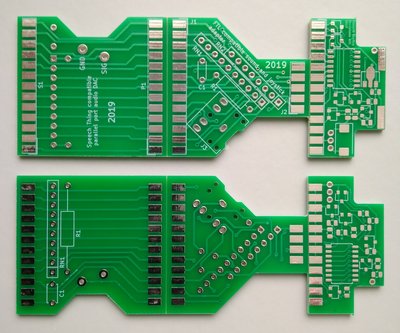

Reply 58 of 93, by Benedikt
The boards have arrived:
271.12 KiB
2260 views
The three parts were relatively easy to separate, because I put the separating line on the mask layer, this time, rather than on the silk-screen.
This creates an ever so shallow groove that is apparently sufficient to nicely guide a blade. The individual parts can then be broken apart with tongs.
