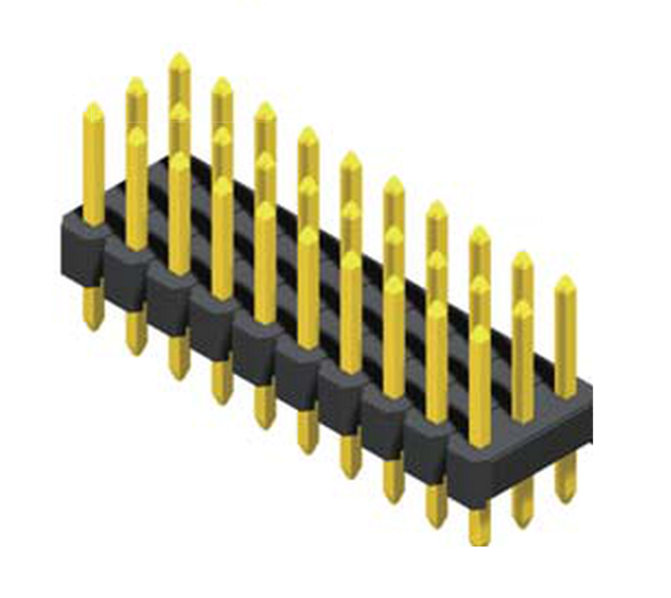

If you have to switch between 18 and 16bit SPDIF output then yes, moving the resistor is the only way to achieve that. I cannot have a jumper block there as it just won't physically fit (6 jumper positions total).
The "220" part has to be moved from right to left to get 16bit SPDIF.
Reply 11 of 80, by PARUS
Why? It may be one 6-row jumper.

Reply 12 of 80, by Tiido
I know such things exist but they are just physically too large to fit anywhere, there's no realestate left on a board for a big thing like that and it also gets in the way of host sound card circuitryp There is maximum of 5mm height on the circuitry.
