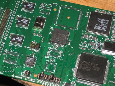

Reply 2 of 15, by Eep386
Here's the card:
1.85 MiB
1834 views
The star of the show, the v4.05 DSP:
1.92 MiB
1834 views

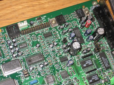

And now a view of the TL074 op-amps:
1.99 MiB
1834 views
Unfortunately the only way I can think of to get v4.05 DSP chips, is from busted old SB16's. At least the one broken CT1740 I had wasn't going to go to total waste.
