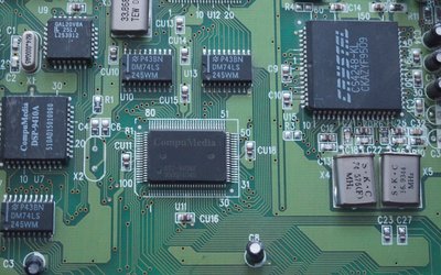

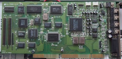

I'm in a process of building retro gaming computer based on 386sx. Today got a sound card named SC-7000 ver 2.0. Research shows that it was made by Galland - canadian company. Tried to look for drivers, found one for SC-6000 and SC-8000 but so far no luck for SC-7000.
Took some pictures.
1.81 MiB
872 views
669.42 KiB
872 views
The card looks promising it has original OPL4 chip YMF278B-F+ 2MB ROM. The other chips are Crystal CS4248-KL, CompuMedia ASC-9408A.
Any idea how to make it work in Dos or/and win3.1 ?
