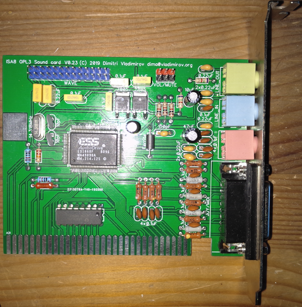

Reply 2 of 13, by GigAHerZ
I haven't seen such resistors since... soviet tech... 😮
Reply 3 of 13, by root42
According to the datasheet [1] it is OPL3 compatible. Yes, it is NOT a true Yamaha OPL3, but we get what he's talking about. Anyway, I think it's nice that people produce new sound cards. The advantage here is that you get SB Pro 2 compatibility (and Windows Sound System as well) on an 8 bit card, which fits into an XT. Can't do DMA other than 0, 1, 3 obviously, and no higher interrupts, but it's nice to have. You don't have to buy it. 😉
However I hope the board is prototype only. I rather like the enig gold coatings. 😀

Reply 4 of 13, by keenmaster486
OPL3, yes, one of the best clones - but also having an ESS ES1868 on an 8-bit ISA card is a win in and of itself; that's a good chip besides the FM component.
Reply 5 of 13, by Dimitri
[1] https://pdf1.alldatasheet.com/datasheet-pdf/v … +/datasheet.pdf
native ess config software operates only with dma 0,1,3 even in 16 bit slot. If the board pass all the tests, then it going to be on ebay )), Resistors yes, soviet, some with silver coated legs ))

Reply 9 of 13, by Grzyb
No WSS.
ESS Audiodrive chipsets have their own 16-bit DAC/ADC, which isn't compatible with SB16 nor WSS.
Now I'm wondering... is that ESS 16-bit sampling available on 8-bit ISA?
If yes, then that card may be The Ultimate XT Sound Card(TM).
And then, a challenge: play CD-quality sound on the original PC platform, ie. 8088@4.77
Reply 10 of 13, by root42
Grzyb wrote:
No WSS. ESS Audiodrive chipsets have their own 16-bit DAC/ADC, which isn't compatible with SB16 nor WSS. […]
No WSS.
I quote the datasheet:
34.56 KiB
365 views
The 16 bit on an XT would be neat. Maybe ModmasterXT can add support? FreddyV?

Reply 11 of 13, by Grzyb
Now that's a big surprise, I used to use various ESS Audiodrive cards, and I'm pretty sure they weren't WSS compatible...
http://cd.textfil.es/mmcd/ENG/TXT/TEXT/TEMP/M5_1.HTM
"It will let you run (...) Windows business applications that are compatible with the Windows Sound System"
Perhaps it's supposed to mean those chipsets support Windows?
Reply 12 of 13, by badmojo
I’ve tried all sorts of ISA Audiodrives and different drivers for them but I’ve never seen them present WSS resources in either DOS or Win9x. I’d always assumed that although the chipset is technically capable of it, that no vendors ever went to the trouble of implementing it.
Reply 13 of 13, by Jo22
Windows Sound System was both a soundcard and a "standard".
Physically, it used an Analog Devices chip (AD1848) originally, as well as an OPL3 for FM.
https://en.wikipedia.org/wiki/Windows_Sound_System
Microsoft Windows Sound system ISA Drivers help.
Using a random 3rd party WSS driver might work on similar soundcards.
A PDF is available here -> https://www.analog.com/en/products/ad1848.htm … roduct-overview
