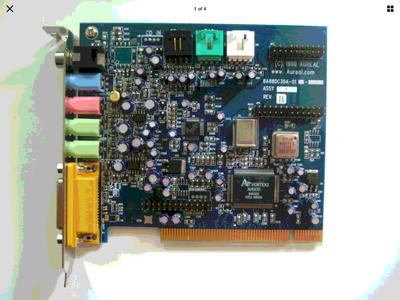

DrSpock233 wrote on 2020-01-16, 08:36:
Thanks appiah4. Oh ok, I'm looking at a Diamond Monster Sound MX300 on ebay, I assume that has an authentic chipset?
It's one of the best known Aureal 2 cards. How much are you looking to pay for one? Locally I have an indefinite supply of these for about $17 a piece.

Reply 15 of 17, by kolderman
MrSmiley381 wrote on 2020-01-16, 11:55:
Personally, I'm running some sort of Aureal Vortex 2 SuperQuad card in one of my machines and it works fairly well. Do other Vortex cards support four speakers natively? The card I have can run digital output but the manual says that if I go digital all four audio channels are mixed down to two. I'm not even sure what the real difference is at the end of the day.
Vortex 2 is better with stereo, headphones in particular. If you want 4 speaker surround, a sensaura based card like the turtle beach Santa Cruz is best.
