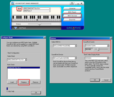

5. SC-55 Sound Font Installation (optional)
5.1 Download Patch93's SC-55 soundfont and extract the archive contents to C:\AU3
5.2 Download SF Pack and extract the archive contents to C:\AU3
5.3 Run C:\AU3\SFPACK.EXE > Ok > File > Add Files > Files of type: SFPack Files > C:\AU3\SC-55.sfpack > Open
5.4 After that, click File > Go/Stop. Wait for about 30 seconds. Now, if everything worked ok, you should have a SC-55.sf2 file in C:\AU3 (file size should be 45.1 MB)
5.5 Start > Programs > Creative > SoundFont Bank Manager
5.6 Click on "Midi Devices" and use the slider to set SoundFont Cache to slightly more than 50 MB then click Ok
5.7 Click on "Bank" then click on the default soundfont (2GMGSMT) to select it, then click Replace, point to C:\AU3\Sc-55.sf2 wait a few seconds until it loads then click Ok
5.8 Run your favorite DOS game (like Duke3D for example) and in setup choose General MIDI for music
49.36 KiB
2310 views
Listen to the MP3s attached to the first post in this thread to check how Duke3D sounds on a SBLive using this soundfont. For comparison, here's Duke3D on a real SC-55.
