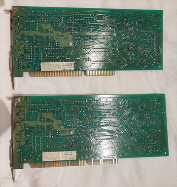

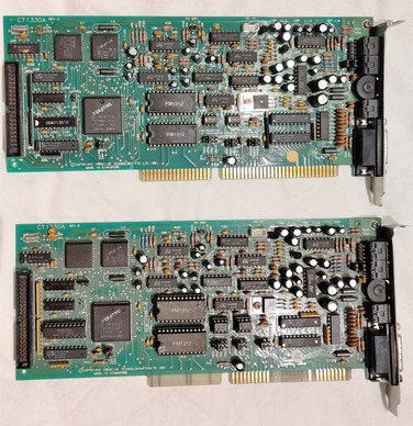

Is there a way you can post pics of both cards? Does the rev 2 have a crystal that the rev 6 does not have?
It does sound to me like there is something wrong with your rev 6 card though, especially since it has issues in the 386 as well.
Mine is a rev 6 and I haven't had those types of issues. What is the serial number on your rev 6 card? Mine is 132418.

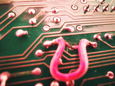

Rev 6 on bottom, rev 2 on the top in both photos. There is a repaired trace on the R6 but it is in continuity only to the correct pads with no bridging.
Serial number as seen in the photo for the R6 is 112542.
The date codes on the reverse are 3591 and 4991 which is incredible that there were 3 more revisions between these two in just 13 weeks. Looking at the state of some of the bodge fixes made on the R2 I'm not surprised there were that many revisions!
In terms of components, there isn't really much change, just a few small capacitors, resistors and bridging wires, no extra chips or crystals.
