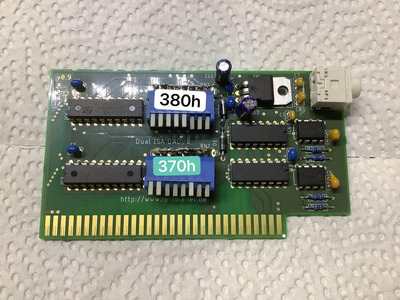

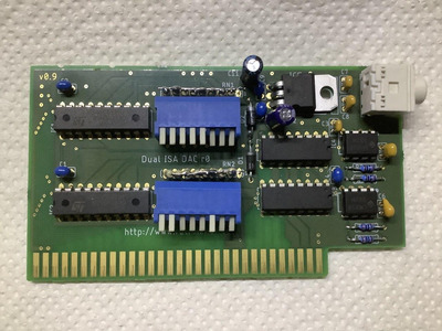

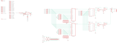

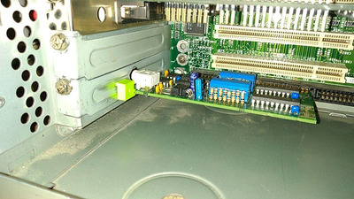

Hi,
i made something really easy, a Covox Speech Thing on ISA Bus Card.
Using AD7524 Digital to Analog Converters and a simple Output Buffer with LM358.

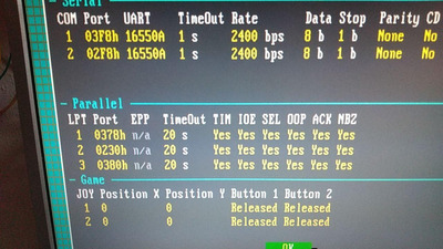

It sounds really nice.

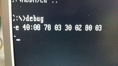

To get it recognized one simply has to modify BIOS Table and enter the Port Adress of each Channel.
This is done with debug.
106.18 KiB
1610 views
124.25 KiB
1610 views

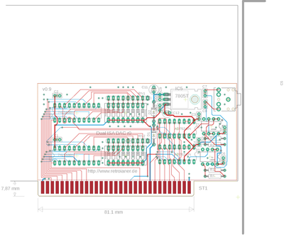

A2 to A9 is connected to 8Bit Comperators, so you can set your IO Adress freely.
I tested already a Lot of Software but had no time yet to to make Recordings!
It does not need a IRQ like a real LPT Port.
Note i know it makes not that much sense as you also can play your MOD Files with a Stereo Soundblaster.
But its fun to try things out.
223.24 KiB
1610 views
223.59 KiB
1610 views
Stereo Playback works fine with Visual Player and some others, and it sounds nice.
65.76 KiB
1610 views
Maybe i have time to do the recordings tomorrow!
I also will Open Source this Project.
So everyone can build one.

130.39 KiB
1593 views
GPL-2.0-or-later
104.49 KiB
1593 views
GPL-2.0-or-later
its really a easy Circuit.

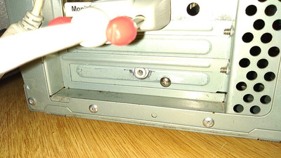

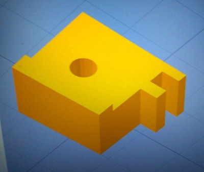

Testing a new Mount:
171.83 KiB
1171 views
47 KiB
1171 views
143.37 KiB
1171 views
