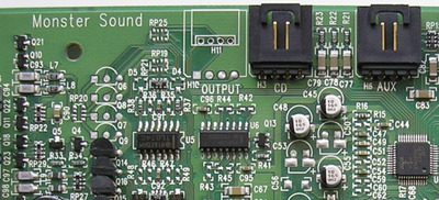

Reply 21 of 27, by Bancho
Has anyone populated the internal missing output header on the MX300? Looking at the board it looks to be missing some circuitry for this header.
87.35 KiB
1112 views
Reply 22 of 27, by SScorpio
Reviewing the linked page about the MX25, at the very bottom is a comment about the MX300 and that the reference 2048 drivers randomly for some hardware won't output SPDIF for all audio. The DVD Player will output over SPDIF, but other audio will not.
I looked through a bunch of other Aureal driver revisions for both reference and OEM drivers. I attempted to use the SQ2500 OEM which is a later driver than anything else but those caused a bluescreen at times, and the control panel had SPDIF disabled just like the 2048 drivers.
According to the Vogon's Driver page the 2015 drivers are recommended for DX 7.1+, while the last revision of the Diamond drivers are based off 2017. The Diamond OEM didn't have SPDIF anywhere in the control panel, but the 2015 reference did have a digital out tab and actually worked. I was able to hear MX300 generated MIDI over SPDIF.
So I successfully piped SPDIF audio out of the MX300 and into the digital CD input on a SB Live. Now I just need to figure out why the port that appears to go from a SB Live Drive to an external aux output card isn't taking SPDIF input. And I'll be able to live the A3D 2.0, EAX 2.0(edit), SB16 DOS dream.
EDIT: I found the solution to the SB Live Drive problem. By default, the Live Drive doesn't route the SPDIF Inputs to the additional header for the rear Digital IO board. There are some undocumented jumpers you can use to change the routing and make it work.
I found the needed information here:
An Advanced SB Live! Configuration
