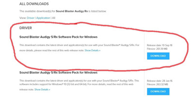

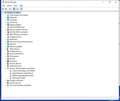

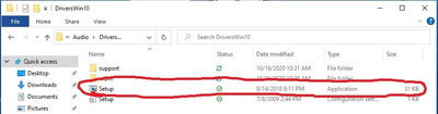

Yes, It does work with the Audigy RX WDM drivers for Win-10.
1) Just download the package and extract to hard drive using win-rar or win-zip.
https://support.creative.com/Products/Product … 0332.1602865886
2) Browse to folder \Audio\drivers Win10\ and run the Setup program to install the WDM driver.
I must have been using the old version of this driver which was causing my computer to crash.
So use the latest version driver for Win10 only.
