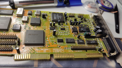

Hi. So I do have this card stored in my box. Recently I wanted to test it out but the sound is just ... as quiet as silence! I can barely hear anything.
Does anybody know where should I search for solution?

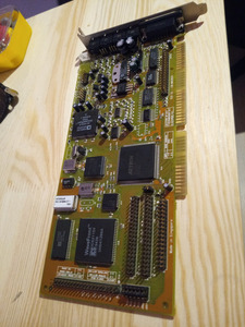

I have one Aztech Waverider with similar problem, at first testing it was very quiet, later it became completly silent. If you can find the source of the problem, please let me know.

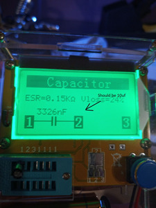

The problem is most probably dried up capacitors, there are a bunch of 1µF ones that don't take much to degrade beyond usefulness compared to a 10µF one.

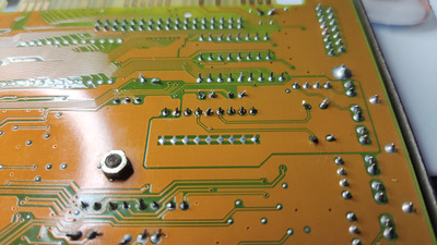

Still no time and lack of caps in storage, but I've managed to take the old ones out.... You were right, some of them were rubbish, two of them behaved like a bad ass diode ... ufff tuesday I'll recieve package so I can finish this work.

I changed caps on my Aztech Explorer this weekend too. My problem described here: Help to identify an Aztech soundcard
So at first try after repair, no luck with original driver package, wavetide.exe just does not recognise card (same with Aztech diagnose software). So i experimented with different Aztech drivers and finally luck with some pnp card drivers got the card alive (SB FM sound) and wavetide found card too (wavetable). So at the moment it works combined with 2 different card drivers. 😀 It was painful experience getting this card alive, but output quality is cristalclear and ymf262+wavetable sound is on most games very nice, so it was worth hassle. Even MT32 emulation (wavetide.exe /MT) sound is pretty good.

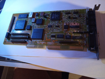

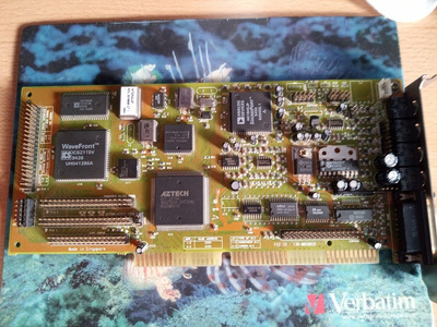

Lately I put a diagnose that amp went down... After change: NO MORE PROBLEMS... So if somebody has an Aztech card and chip TDA1517 having similar problems, change this one and You should bring it to life again.
By the way.. IMO this is the best ISA soundcard for DOS gaming. No clicking, very loud, compatibilty with SB, SB16, SB PRO, and it has Wavefront chip on it so I can enjoy and play dos games in 2022... With totally new experience. I highly recommend this card, which btw is WaveRider32+ version. I will do some YT material about this one later one as it really deserve it.

My problem is similar but a little different also. My card works perfectly fine but FM sound from the YMF-262 is much too quiet. To have it balanced I have to reduce digital to half (8/16).
Wavetable is loud enough but is joined with FM volumewise. So it is far too loud compared to the reduced digital sound.
Any Ideas what the reason behind the reduced FM sound may be? There are no other issues with the card.
Edit: To those of you who are interested: I solved the problem on my own. Following the YAC 512 datasheet, the analog outputs are directly conected to the input of an opamp without gain, a simple buffer. Aztech put a resistor (10k) in series to each YAC output. I replaced them with lower values and voila! Problem gone!
