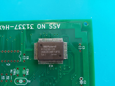

Though there is a clear warning about the two missing chips I thought maybe it is possible to transfer this ICs from one of the other Roland Cards.
The MPU401/AT seems to have the identical QFP IC.

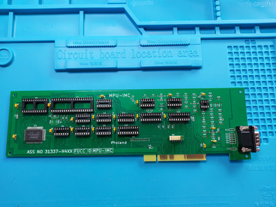

So I went ahead bought an original breakout box from eBay and produced some of the "stock" PCBs.
The producer refused to print "Made in Denial" on the PCB, 🤣.
I took of the Microcontroller (Motorola 68001 + ROM?) and logic chip from a known working card.

Installed the SMD mount chip (most tricky part, I reworked it later)
957.82 KiB
367 views
All ICs get sockets.
1.47 MiB
367 views

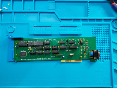

The card is almost finished.
1.35 MiB
367 views

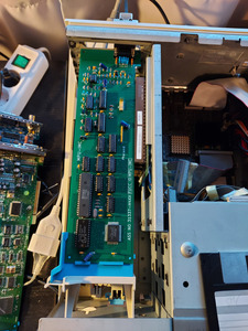

Time to test it.
1.72 MiB
367 views
The card gets actually detected by the BIOS and can be configured using the IBM reference disk.
If I hook up the breakout box, the buzzer in the box beeps all the time.
This is similar to a normal MPU-401 if it has a faulty ROM.
If I remove the SRAM or the microcontroller, then it becomes silent.
I also tried different microcontrollers from the original MPU-401 and a CMS-401 clone card. (No buzzing)
But I can't get DOS games to detect the interface.
I had to change the interrupt from 2/9 to 3 because IRQ2/9 is used by the onboard SCSI controller.
Was I silly to believe it could be done that easy?
Any ideas how to rescue this project?
If you are up for experiments I have 2-3 of the PCBs that I can spare.

Reply 2 of 3, by cricket
I checked the original schematics from Roland and found an error in it that transferred to the clone card.
After fixing this the Computer was able to detect the MPU-401 and DOS games claimed to be playing music.
However, no data was detected by the midi device.
So I took apart the breakout box I bought on eBay and swapped out the ICs for new ones.
Now the card is working!!!
