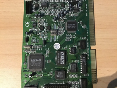

Hello everyone,
Recently I found an old ISA sound card (see attachments). However, on the internet I find no information about this at all?
Can someone help me? which brand, type?

Well the model is a "Sound Image Orchestra 32+" as it's written on the card. But you're right, there's very little information about it. It appears to be made by a Russian company called "antares", which is equally unknown to me. Maybe it's a rebranding of another card? If you're after the features that should be easy to determine by the chips, if you're looking for official software etc it looks difficult.
Reply 3 of 8, by keenmaster486
Just one of those generic Crystal sound cards. It'll do all of the usual DOS things.

Found a PC Magazine : Russian Edition article that mentions it:

I think Antares may have just been a distributor that you could buy it from.

Can't help you with brand and type, but can tell you something based on the chips:
- Crystal CX4232 - very good sound chip, low noise levels, excellent Sound Blaster Pro 2 and WSS support with bug-free MIDI.
- Crystal CS9233 - MIDI synth, so 'wavetable' generator. Generally very well-regarded. The CS9233 also handles the FM synth functionality. Doesn't sound like 'real' Yamaha OPL3, but supposedly not too bad either.
- Crystal CS4112 - 1MB sample ROM. A bit low-end, but probably very serviceable.
Given there is no other custom logic, this card would probably work with generic Crystal CX423x drivers like these:

Hello all,
thank you for steering me in the right direction. I have put the card in my retro P3 (SE440BX-2 motherboard) with Windows 98 SE install on it and it is automatically recognized by Windows 98 SE as "Sound Image Orchestra 32+" and above all it still works.
Now I'm going to try install the DOS drivers from vogons. To be continued.
