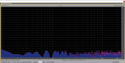

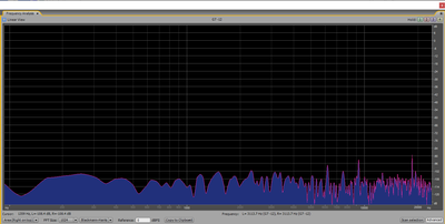

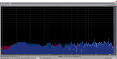

You always hear me mentioning noise and I think I may have overstated its impact .
I made some comparison between analogue with every analogue input at 31 and min-digital with the same settings with nothing playing (background noise) .
Full disclosure :
- I am currently running the Orpheus digital out through an SB Live! (and it 48KHz resampling) into the VS-880EX digital in and recoding it's optical out , so these measurements are relative and don't say anything about the Orpheus' absolute performance .
- Volume levels are almost certainly not optimal .
- I likely don't fully know what I'm doing (but I'm learning).
min-digital :
The attachment min-digital.png is no longer available
analogue :
The attachment analogue.png is no longer available
The only reason I can hear the difference between the two is because the VS-880EX headphone out allows an EXTREME amount of analogue gain while being EXTREMELY quiet . If I were to try to get close to actually listening to anything other than background noise at those gain levels, it would be ear-drum splitting and totally pointless .
The VS-880EX is so clean in it's DA + headphone amplification that I can actually hear the difference in noise character, at or below -90dB, when I'm typing, but only when the CS4237B's ADC signal is routed to its digital out (EDIT : when Orphinit inits in analogue mode, with all analgue inputs muted) . My previous Akai DPS12 did not allow for so much clean gain and as I was used to using it and not the VS-880Ex, I do not realize what an idiot I was being .
Moral of the story: let a newb have too much fancy equipment and he will find the best way to make himself look dumb .
The attachment wavs.zip is no longer available

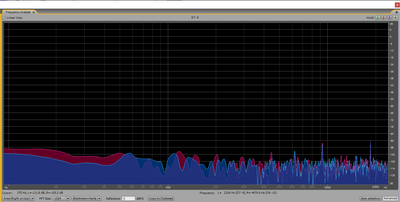

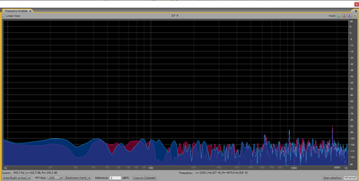

Reply 8 of 184, by darry
I made a comparison between the Orpheus' digital S/PDIF out with Orphinit being set to "analogue" mode with every analogue input at mute AND MIC input at either 31 or mute with nothing playing (background noise) . Setting MIC to 31 is quieter than setting it to mute . I have included my ini files .
Again, full disclosure :
MIC mute
The attachment ORPHEUS_analogue_mic_mute.png is no longer available
MIC 31
The attachment ORPHEUS_analogue_mic_31.png is no longer available
The attachment ORPHEUS_analogue_mic_mute.INI is no longer available
The attachment ORPHEUS_analogue_mic_31.INI is no longer available
The attachment analogue_mic.zip is no longer available
Reply 9 of 184, by darry

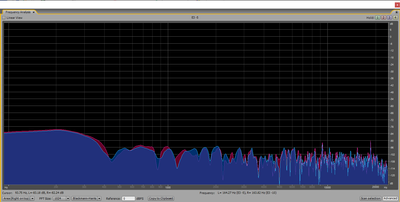

I now know with I initially thought that the wavetable input was noisy. It is because it is, BUT only under Windows with the PV2860 driver and digital output enabled . Under DOS, using Orphinit, it is fine .
I made a comparison between the Orpheus' digital S/PDIF out with Orphinit being set to "analogue" mode with every analogue input at mute except MIC input at 31 and WTHeaderVol at 8 . Nothing was playing (background noise) . No wavetable card was installed . SRS had to be enabled under Windows or analogue input would not work in Windows. The Synth slider in Windows had no effect on background noise .
Orpheus digital out in DOS with WT enabled :
The attachment ORPHEUS_dos_analogue_mic_31_wt_enabled.png is no longer available
Orpheus digital out in Windows with WT enabled :
The attachment windows_srs_unmuted.png is no longer available
Orpheus Windows mixer settings (the Synth slider in Windows had no effect on background noise ):
The attachment windows_srs_unmuted_mixer.png is no longer available
INI file used :
The attachment ORPHEUS_analogue_mic_31_wt_enabled.INI is no longer available
wav files :
TLDR : When using S/PDIF output (I did not test analogue output)
- Using Orphinit, Orpheus is fantastic with analogue input enabled (wavetable) or without under DOS (slightly quieter with analogue input disabled)
- The PV2860 Windows 9x driver sucks is sub-optimal if analogue input is enabled (at least when using digital output).

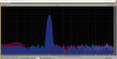

Reply 10 of 184, by darry
Following up on the previous post.
Here is a 1KHz tone, generated with a peak of -3dB being played on the Orpheus through its digital out (routed through an SB Live!) under DOS in Open Cubic Player 2.51 (2.6 has issues for me) . The init settings are the same as in the previous post . Wavetable input is enabled in DOS . SRS is enabled but zeroed in Windows (as in previous post) .
DOS
The attachment ORPHEUS_1khz_dos_analogue_mic_31_wt_enabled.png is no longer available
Windows
The attachment ORPHEUS_1khz_windows_wt_enabled.png is no longer available
EDIT : And the actual wav samples from this post and the previous one .
The attachment more_wavs.zip is no longer available
EDIT 2: Maybe I should post average amplitude statistics . Though with the provided wav files, anyone can do it .
EDIT 3 : Please disregard the 1KHz tone results . There was an issue with Open Cubic Player 2.51 as well as I was using DOS4GW.EXE ver 1.94 . Using ver 1.97 fixes it . As I now have a setup that will allow direct digital recording at 44.1KHz from the Orpheus, I will likely not be re-doing this specific test through the SB Live! passthrough setup .

darry wrote on 2020-11-09, 03:38:
I now have a direct 44.1KHz (no resampling) recording setup using a CM108 USB interface with optical input. While setting it up, […]
I now have a direct 44.1KHz (no resampling) recording setup using a CM108 USB interface with optical input. While setting it up, I found a strange issue and its strange workaround that may or may not be unique to my setup .
The issue in question is distortion while playing back a wave file using the WSS mode in DOS after a cold boot .
It is easily reproduced by playing a 1KHz sine wave file (16-bit 44.1KHz stereo) in Open Cubic Player 2.51 and more difficult to notice but still present when playing the same file in MPX Play 1.65G .
In Open Cubic Player, the issue is also noticeable when playing modules .
It affects both analogue output and S/PDIF (in both min-digital and analogue modes, with S/PDIF set to on EDIT : also with S/PDIF set to off) .
It is also present when initializing with UniSound .
BUT, booting into Windows with the PV2860 driver installed and then rebooting resolves the issue completely in DOS for as long as only soft boots are done . Re-initializing the card does not bring back the issue. Only a cold boot will bring back the issue . I already went through both all indirect control and WSS registers before and after running Windows to try to find a significant difference, but even manually setting all those registers to their post Windows values after a cold boot does not seem to changer anything (I may have missed something, so I will likely try again) .
The system that I am running this on is 815 based and uses an IT8888 ISA bridge, which may be a contributing factor . An AWE64 in the same system does not display the issue .
I have a strong feeling that this issue is system specific, so I will likely try the Orpheus in an Asus P3B-F to compare .
Any suggestions appreciated .
Here are the WAVE files I recorded during my comparisons.
1khz_issue.zip
I have narrowed it down a bit . It's my Voodoo 3's fault ! I have an AGP Geforce FX 5900 and a PCI Voodoo 3 3000 in that system . If I set the FX 5900 as primary VGA in BIOS, the issue is not present (from a cold boot or otherwise) .
If I set the Voodoo 3 as primary VGA, the issue is present from a cold boot, but running Windows fixes it temporarily (until the next cold boot). I have compared the Voodoo 3's PCI registers before and after running Windows and found no differences .
I find this very strange .
EDIT : I tried flashing a random assortment of SDRAM Voodoo 3 PCI and AGP (they seem to work on a PCI card) BIOSes to no avail . I also tried changing some Voodoo 3 PCI initialization registers using TDFX BIOS editor.
I would really like to know what Windows and/or the 3DFX drivers does that mitigates this issue .
EDIT2: Same symptom with a PCI Voodoo 3 2000 .
EDIT3 : I tried a PCI Voodoo 3 2000 in an Asus P3B-F along with Orpheus . I get even worse weird distortion when playing the 1KHz test tone file in Open Cubic Player under DOS, but if I open the help menu by pressing F1 , all on-screen movement stops which also stops the distortion . Running Open Cubic Player under Windows does not cause the issue . Soft booting from Windows does not mitigate the issue, which differs from the behavior observed on my 815 board . Finally, when using an FX 5900 XT AGP as a primary VGA , the issue does not occur . This is definitely a strange Voodoo 3 issue, IMHO .
EDIT4 : I tried with a YMF715 based Audiotrix 3D/XG and an Opti 929 based Turtle Beach Monte Carlo, and the same issue is present in WSS mode . This has nothing to do with Orpheus. It seems to be a strange incompatibility between WSS mode on any ISA card and Voodoo 3 cards .
EDIT5 : I found a usable workaround . Initiating a short playback session using LMP 0.9 (by Lada Kopecky) on the SB Live! that is also in the system, but whose ins and outs are disconnected from everything, mitigates the issue (Initializing the card using EKM049 is not enough) until a cold boot. I should probably test with the Live! removed from the system, but I just can't be bothered . Case closed as far as I am concerned .
