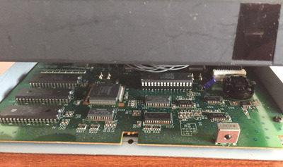

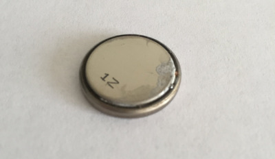

I tried that, but after removing all the screws (I double checked), attempting to lift the top of the SC-155 still results in a fair bit of resistance. Now this could very well be because the device hasn't been opened in years, but I would rather not force it without knowing for certain that this is how you're supposed to do it.
EDIT - success! Just after writing that, I gave it another shot and managed to replace the battery.

Here's how I went about it. Instead of trying to completely lift up the top, I only slightly nudged its lower half open (see picture above). Fortunately, that was enough for me to access the battery holder and remove the damn thing. Of course, it had started to leak, but thankfully, not too much. Good times!

It's likely that the display board is attached to the top of the unit and then links to the main board with a flat cable. In those cases you can usually flip open the module of synthesizer like a book after slightly lifting the top half (some synths even have hinges build into the case for this purpose).
In your top picture of the internals you can see that cable right behind the battery holder, I think.

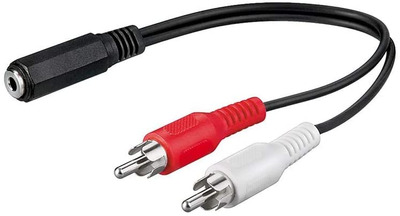

Nice! At the moment, I prefer to use the headphone jack because the RCA outputs seem to produce a slight buzz while paired with this somewhat flimsy adapter:
28.9 KiB
458 views
I have ordered a higher quality adapter cable which should hopefully resolve the issue. But if it does not, then it's good to know that the headphone jack remains as a viable, buzz-free backup.

Hmm, if you're hearing a buzz, I'd usually say that's down to a ground loop or the PSU.
I was using a power bank > roland specific step-up adapter I made to listen to the headphones, but I had another go with the mains PSU that the MT90S usually uses. I did hear the buzzing sound if I use amplified headphones, but not with unamplified headphones, on the headphone port. I can't find the adapter for phono > 3.5mm right now so I can't check that 😀
The mains PSU I'm using is one from ebay, since every roland thing I've bought so far has come either with no PSU or the wrong power supply.
