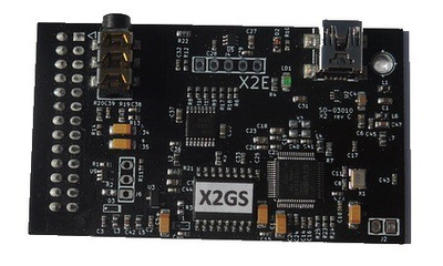

DreamBlaster X2GS
waveblaster compatible soundcard featuring dual soundbank support :
  • a preloaded officially licensed, read only 16mbyte GS bank.
  • an updatable user bank (up to 48mbyte).
34.73 KiB
8544 views

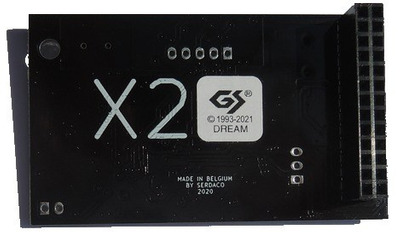

    24.19 KiB
    8544 views

Reply 9 of 307, by Lennart
Yet another nice MIDI daughterboard, congrats! 😀
Am I correct in assuming that the hardware is essentially the same as the X2, except instead of having 64MB of Flash memory for an updatable sound bank it splits it into 2 banks (16MB preloaded GS bank and 48MB updatable)?
Also, what is the difference between the 16MB preloaded bank of the X2GS and the Dream Cleanwave128 bank? I was always under the impression that the latter used Roland samples as well.
Reply 10 of 307, by dreamblaster
Lennart wrote on 2021-04-24, 14:32:
Yes
It has different firmware, different memory organisation, .. but hardware is the same basis.
Due to licensing restrictions, and needed encryption/protection for the GS bank, this is explicitly a separate product.
It is forbidden for this product to use in musical instruments, and forbidden to distribute the bank outside of the product (seems this is very important for Roland - I need to note this).
X2GS uses Roland samples, officially licensed by Dream
Cleanwave uses "clean" Dream samples as far as I know.
Thanks for your support !
