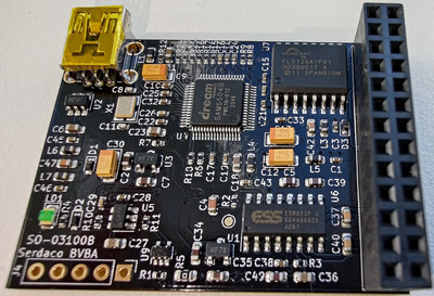

Reply 266 of 288, by vutt
I got recently released X2GS Second Edition version. Almost everything seems to be shrunk down.
It appears SE version uses ESS DAC instead of AKM. So is it better or perhaps it's down to component availability. It's bigger more expensive brother X16 uses also ESS DAC.
I have SC-55K to compare. DreamBlaster implementation sports clearly richer sound signature with slightly more emphasis on lower frequency band. I like it. OG SC-55 sounds dry next to it.
Note: New PCB design has usb port inside. So make sure you have sound card components clearance. In my case with original Orpheus card X2 usb port makes slight contact with Orpheus electrolytic capacitor. So I treated X2GS usb port with Kapton tape for isolation. Looks also better on dark pcb
505.11 KiB
1030 views
Reply 267 of 288, by Rawit
Very interesting. I've compared the datasheets of the DACs and it looks like the AKM has a reference diagram using 1.13Vrms output while the ESS includes a 2Vrms Op-Amp driver. I'm a complete n00b in this department but does this mean the ESS has more power in the output if the datasheet setups were used?
YouTube
Reply 268 of 288, by Rawit
I now own both the X2GS and the X2GS SE. I'm happy to report that the X2GS SE is louder then the original. I'm using it externally with the CHiLL & Phil adapter and it seems that the ESS DAC delivers more power which the line-in of my ESS sound card likes. Everything has the same levels now after a quick test.
