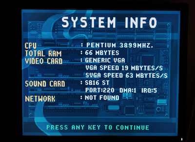

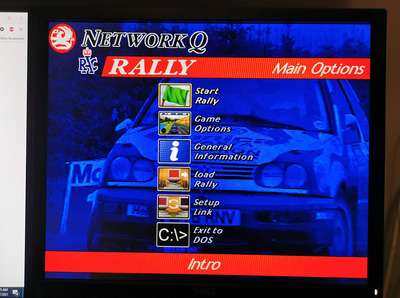

Games tested: MK2, NQ Rally, Doom, Heretic, Duke, Quake, Screamer - all are starting with sound/music. (I know they are fairly new)

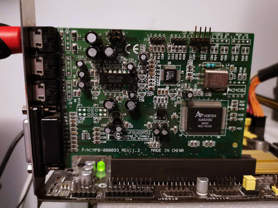

The newest board where I could get sound in pure DOS was: Asus H81M-C/i5-4570
On this board AU8820 it simply works in DOS 6.22 with games mentioned above - using default BIOS settings.
Also, Windows 3.11 can start in enhanced mode using on board SATA set to IDE > Legacy mode. Sadly, AU8820 is not recognized in Windows 3.11.

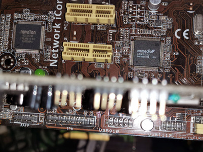

NB: There is no native PCI support, this board uses an ASMEDIA PCI-E to PCI bridge chip. So there is hope, it might work even in newer Intel motherboards.

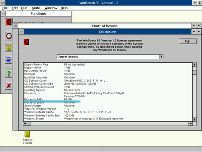

I tried bretjohnson's Slowdown, but it hangs. Maybe 64MB cache L3 it's confusing for this type of tools. Fun fact: Winbench 96 detects this L3 cache as processor RAM:
What slowdown tools are working on newer CPUs?
