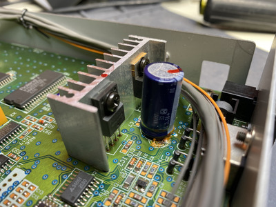

Reply 29 of 34, by polpo
I opened my SC-55mkII up and the glue is still kind of pliable and doesn’t seem to have caused any corrosion on the board. Still doesn’t look good and I’ll be scraping it away just in case. I opened it up just after unplugging it and the nearby heatsink is still pretty warm. With my current setup I have it plugged in and in standby all of the time and it’s cooking that poor capacitor. I’ll definitely be putting this on a hard wired switch from now on.
