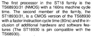

EDIT: You can find also information about the TS68390, it's the first implementation of the ST18 core. There is available online a full datasheet of that model.
EDIT2: How are you reverse engineering the firmware? IDA Pro nor Ghidra support the ST18. And I've been searching for the SDK and it's nowhere to be found.
The TS68930 (you have the digits mixed up) is the NMOS predecessor of the ST18930, which is manufactured in CMOS. A full datasheet (including detailed opcode layout) is available in the databook http://bitsavers.informatik.uni-stuttgart.de/ … pplications.pdf starting at page 554. That's the most comprehensive documentation I have about the ST18 architecture. I used that documentation to roll my own disassembler. It turns out that the ST18932 core is (mostly) binary compatible to the ST18930 core, but has some extra capabilities.
