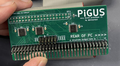

Hardware
The hardware is a pretty basic 8-bit ISA card that brings address, data, port IO, IRQ, and DMA signals to the Pi's GPIO connector. I am using TI TXS0108E auto direction sensing level shifters for the bus interface to translate between 3.3V and 5V and that seems to be working well. Real translating bus transceivers would be ideal, but I am basically out of GPIOs in the current design for an input/output direction signal. The lack of GPIOs is also the reason for only using an 8-bit ISA card – there aren't enough GPIOs for the lines necessary for 16-bit DMA, etc.
Here's the board. I originally designed it so the Pi could plug right into it but got the orientation of the connector wrong. With this design the Pi is connected via a ribbon cable. Inspired by the GUS, there is a pin header with all ISA lines present, which helps with connecting a logic analyzer or adding any bodges (which I've been lucky to not need so far).

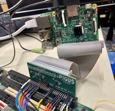

And here it is plugged into an ISA slot on a Pentium 133MMX board. The wires connected to the ISA pin header are going to my logic analyzer.
