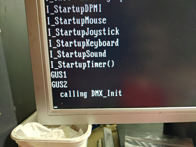

Went ahead and tried a couple of different things to see what does not work and what doesn't either. 😁
First I tried Doom. Didn't work. BUT - didn't crash with the "Dude, the GUS ain't responding." but froze on "calling DMX_init"

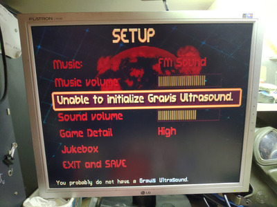

Second I tried Tyrian2000. Didn't work, threw message about GUS not existing.

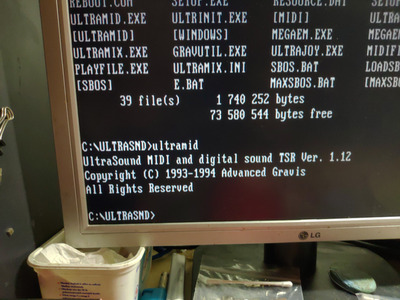

To test the music I had to load ULTRAMID.EXE TSR, so I tried it just for funs and giggles. To my suprise - it did work! Didn't previously.
The attachment P_20221216_215523.jpg is no longer available
But - the only thing it produces are clicks. I believe the samples are not being uploaded correctly to the memory but I am nowhere near expert enough to understand what it is trying to do. Took a video of it instead. Here is a test of BLOOD. Duke3D did the very same thing since they both run on the same engine. From the HDD activity it loads all the data to the memory and then plays the music but only clicks can be heared.

Reply 127 of 1502, by polpo
Thanks for all of those testing results, @krivulak! I've tried Doom and it now fails in exactly the same way, so that's actually encouraging. ULTRAMID loading is surprising and good news.

Reply 128 of 1502, by jmarsh
FYI Tyrian2000 expects ultramid to be loaded manually before starting it (even for digital audio only). A lot of other "ultrasound compatible" games rely on it too but use an embedded version.
