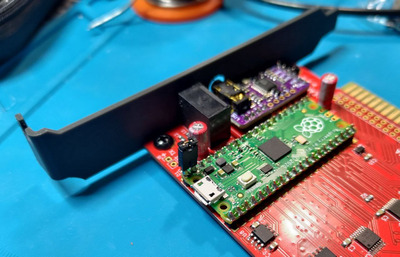

Reply 570 of 1502, by n0p
@polpo
Updated FW on my 1.1 to 1.0.1 - LED is certainly more informative now 😀
Regarding gamepad support - i don't seem to get any power from Pico's USB port.
Might it be safe to check if microusb port works by trying to power Pico from external source, or it might damage something on board?
Reply 571 of 1502, by Shreddoc
n0p wrote on 2023-11-30, 18:58:
@polpo Updated FW on my 1.1 to 1.0.1 - LED is certainly more informative now :) Regarding gamepad support - i don't seem to get […]
@polpo
Hey n0p, I noticed your question, and thought to refer you to this post by polpo. I have bolded the relevant parts :
Re: PicoGUS: ISA sound card emulator with Raspberry Pi Pico (Gravis Ultrasound, AdLib, MPU-401, Tandy, CMS)
"The main benefit of this [v2.0] board (in addition to the possibility of "mass production", and the cool metal bracket) is the USB-A connector so you can easily plug in USB joysticks. The latest firmware has a preview of joystick functionality: plug in an Xbox 360 or DualShock 4 pad and you can use them in your DOS games. This functionality is also possible with the original PicoGUS design, you just need to use a powered USB OTG cable on the Pico's micro-USB B port to plug in your joypad."
Supporter of PicoGUS, PicoMEM, mt32-pi, WavetablePi, Throttle Blaster, Voltage Blaster, GBS-Control, GP2040-CE, RetroNAS.
Reply 572 of 1502, by n0p
Shreddoc wrote on 2023-11-30, 19:57:
Thanks! I never known powered OTG cable existed, so my mind just skipped that part 😀 Sorry.
As a side note - i use Waveshare Zero (Pico clone) to connect external keyboard to Book8088 and it works there fine w/o external power source. And my test env is original Pico - and there keyboard powered as well.
Might it be possible to mod the 1.1 board to allow usual OTG adapters?
Reply 573 of 1502, by Shreddoc
n0p wrote on 2023-11-30, 20:20:
An easy problem is a happy problem! Enjoy. I too need to organise a powered OTG cable for myself, for this purpose. Or might make one.
Reply 574 of 1502, by polpo
This is the powered cable I've used in my testing: https://www.aliexpress.us/item/3256805897631266.html You could also use a powered USB hub if you have one of those.
You could also bridge VSYS and VBUS (pins 39 and 40) on the Pico but after you do that, if you need to flash your Pico from your modern PC, you should not plug it in via USB when your retro PC is powered. That's because the retro PC will backfeed 5V into the modern PC's USB ports and they may not like that.
Reply 575 of 1502, by n0p
polpo wrote on 2023-11-30, 20:32:
Thanks! So a 2.54 jumper should do, just not to forget to remove it when changing firmware, do i get that right? Or you meant flashing via USB port when host PC is on?
Got it. You warned about not trying to connect two power sources at once.
So i tried connecting VBUS and VSYS together and it looks like not enough power for gamepad. I can source that kind of OTG cable for about 4 bucks right now, so i guess that's the answer 😀
Thanks again and sorry for dumb questions.
Edit: Gamepad not geting enough power appeared to be bad late night soldering. XBox gamepad works! (in Shamus at least)
