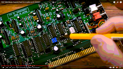

Reply 22 of 67, by scg
kdehl wrote on 2023-05-03, 12:04:
Hi sgc! How's it going with this board? Did you manage to resolve this last issue?
Recently a video was released on the LGR Youtube channel about the IMFC: https://youtu.be/lyIBfjsTZcQ. The screenshot from this video clearly shows that the RA1.2 pin is used.
According to my layout, the only place the wire from this pin can go is the ISA AEN line. No matter how hard I tried, I could not get another option. Therefore, I decided to stop at this option and ordered a test board from the factory. As soon as the board comes, I'll try to build that.

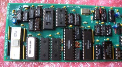

Reply 26 of 67, by scg
Physikant wrote on 2023-06-17, 22:34:
Is there some github or something of this project? I would like to try to assemble one myself, even if there are some flaws in this version 😀
You can find the KiCad project here: http://svn.stdio.ru/svn/trunk/imfc_clone/hardware/
I have already assembled the board completely. Once the card even played in games Space Quest 3 and Silpheed.
However, as soon as I wanted to capture it on video, device stopped working. Now I understand the issue with the help of a logic analyzer. It looks like software bugs and the drivers don't want to run on relatively fast machines.

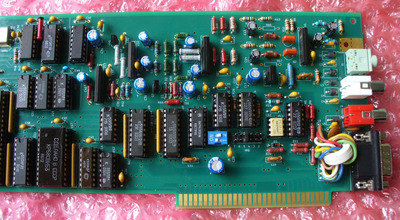

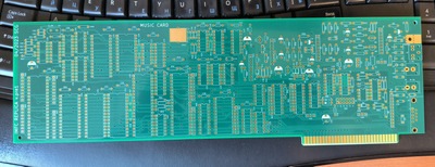

Reply 27 of 67, by scg
Here's what the music map looks like now.
To Physikant: for some reason, I do not have the permissions to respond on private messages, so I will answer your questions here.
a) How on earth did you figure out the layout of the top sub layer (In1.Cu)? The grounding seems wild to me! Are you sure about this?
No, not sure. Of course, I couldn't see the inner layers in the photos. The result of my work is a reconstruction based on speculation.
Key Ideas:
- The board has four grounds: Digital, Analogue, DAC and Chassis
- The corresponding circuit is connected only to its ground
- The grounds are connected to each other only through one point
Based on the available photos and these rules, I tried to layout the ground. Perhaps a little wrong. I also found one mistake in element ZD1.

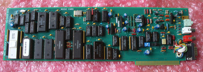

b) It seems that while your card closely resembles the revision C of the IMFC, the fix in the layout around C26 is from the rev D. Did you find other differences between the two revs (besides the switch to a mask rom)?
This project is not a copy of a specific revision of the board, but an attempt to reconstruct the device itself.
The good quality photographs available were barely enough to reconstruct the circuit. The connection of a large part of the wires had to be thought out based on the programming documentation. Therefore, it turned out to be impossible to copy the board 100%. Especially to compare revisions.
c) You wrote that the card doesen't work as intended but you think that it is dependent on the speed of the PC. How do you know?
I recorded the exchange protocol of the card with the software using a logic analyzer, and did not find any problems with the card. But in the driver disassembler from Sierra, I found a delay function based on empty loops:

Reply 29 of 67, by scg
Physikant wrote on 2023-07-02, 18:44:
Did you already correct the error on ZD1 in your schematic/board? What was the error?
Yes, I fixed it, but I haven't committed it yet. GND was connected to the wrong layer.

Reply 30 of 67, by scg
It turned out that the device was in conflict with the Sound Blaster! The Blaster does not use all address lines for decoding, so it began to occupy the bus along with the IMFC, and prevented it from working. There were no software problems with the drivers, it turns out.
It's alive!
https://youtu.be/Qtrv1dVRlp8?si=iWqK-Klu9iQlyCnD

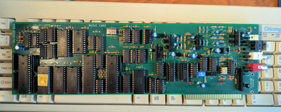

Reply 36 of 67, by Tronix
I am the second lucky owner of the board from scg, thanks to him for the work done on creating a replica.
I assembled my board from the parts I have available, so it does not look very similar to the Yamaha original 😀
However, it works great just like scg's board.
