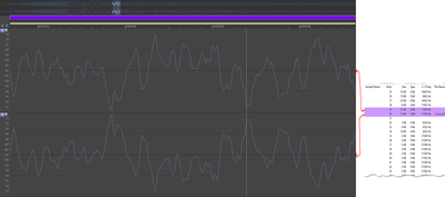

Skaven prepared many sample instruments that range from percussive instruments to sound effects. He denoted them with $ sign. I loaded "SWOOSH"and " SWOOSH$" as an stereo file to confirm they are inverted.

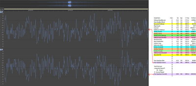

Purple Motion seem to have only inverted one sample #30 named "surround" that is an inversion of unnamed sample #29. The result is a similar channel inversion. It's the swish sound you often hear in between parts, for instance when you leave the pixel tunnel just before the moiré circles.

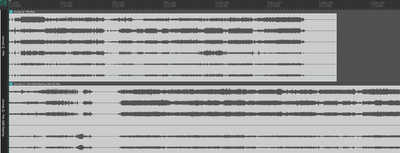

Here is a render of both music (2nd_skav.s3m+zoom on left and 2nd_pm.s3m+zoom at right) with only the surround instruments. Skaven implementation seem to be more ambient, although most of the time he would not use it's surround counterpart. I think the place where his surround effect is most important is at the "Swoosh" sound when you have the hyperspace blast shock wave fade to white. Even so, I put that sample in solo for the red zoom section rendering and it still look far less obvious than Purple Motion who seem to have a more perceivable approach using visual tools.
This mean that a Dolby Pro Logic decoder that support analog matrix encoded signal could render this music properly in surround. Or maybe there is a software that could help prepare an upmix for modern digital receiver using an recording or a rendering of the original audio ?

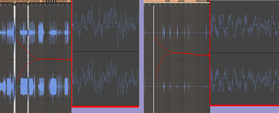

I used OpenMPT to render the two .s3m music as it was more convenient now, but I assume the audio from a DOSBox movie would work as well. FreeSurround have an option called "Redirect bass to LFE (.1) channel" that is off by default. On this screenshot you see Purple Motion on top with the option on and on bottom is Skaven with the option off.
6 channels: front left, front right, front center, LFE, back/surround left, back/surround right
82.65 KiB
565 views
On my receiver both version and the subwoofer sound the same to me. I understand next step would be to not even bring this channel to the export using MatrixMixer.
