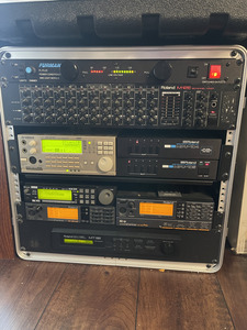

This is my current MIDI tower.
Tried to make an interconnection between all the units but it’s a mess.
How do you manage connections to the computer and keyboards?
MIDI splitter? MOTU Interface? Half-rack preferable.
MIDI modules: = Roland MT-32, MT-32Pi, MT-100, RA-30, SC-55MK2, SC-88, SC-88Pro, SC-8850, JV-1010 = Yamaha TG100, TG300, MU80, MU100, MU128 = Korg X5DR, NS5R = CASIO GZ-50M = KAWAI PHm

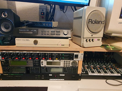

Reply 6 of 6, by Boohyaka
I use a Roland A-880 for MIDI signals, and a Behringer Eurorack Pro solely for MIDI sound outputs. Love the individual channel mute buttons on it, super handy.
Then I have a stereo splitter behind the Eurorack that feeds a channel on two Behringer mixers x1002b, to mix MIDI with other sound cards on different computers. Part of it:
