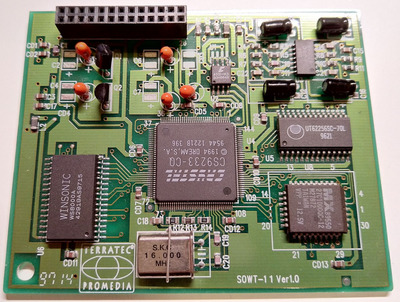

Today I was going to test how this wavetable board sounds, but I was unable to get any sounds out of it. Tried it with two different Sound Blasters, CT2980 and CT2950. Once I heard some weird low volume crackling noise, thats all.
-MPU401 output is working, I play Ultima 7 daily using MT32pi configured on port 300 without any additional software. (Ultima7 doesn't find it on default port 330)
-Also had some problems with FM & adlib, could not get any sound out of that either. This got solved running unisound. Unfortunately it had no effect to wavetable synth.
-I have tried different SET MIDI=SYNTH:0/1 MAP:x etc settings without positive results.
-Mixer is set everything "ON" and high volume.
-Selected "General MIDI" on port 300 or 330 (Doom, TTD).
-OS=DOS 6.22
Some sites claims that CS9233 needs TSR to be loaded, but what that means with this setup? Is SoftMPU enough? - that didn't help anyway.
I assume the board is broken. Before I do any desperate repair attempts, can you explain how Wavetable daughterboard is normally configured to produce sound? Better yet if Dream/Crystal synth.
Toshiba T8500 desktop

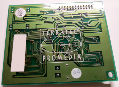

Can you show photos of both sides of the board ?

North of CS9233 is located CS4331-KS DAC from where analog output is buffered using 064 OP-amp located NE corner. If I can build some kind of test bench I'll measure supply voltages and then scope input and output of the DAC. If there is some data I might have a change, this is getting interesting...

Reply 3 of 8, by Tiido
Nothing looks visually wrong. There is a good chance the 4 black capacitors are dead. I have had to replace these on one card I worked on to get sound output (but it did have one, just really really quiet).

Reply 5 of 8, by fool
Current setup is GA-586TX with Terratec Base-1 + some random ethernet and Matrox G200. I don't have any other wavetable cards, this is actually my first one. Thats why I'm fishing for configuration hints. Now I use Windows 98 MIDI player and I have changed MIDI playback=Roland MPU401 from multimedia settings in control panel. Everything plays fine when MIDI device= default internal "Yamaha OPL3/FM", but not with the wavetable.
Today measured the board and found some cracked solder joints from TH regulators etc. Re-soldering those did nothing special. Also measured signals with oscilloscope. Saw nothing from the digital and analog outputs. Supply voltage is a bit low, about 4,7V. CS9233 datasheet recommended is above 4,75V. I don't believe it's too low but I have to check it. UART data comes alive when midi file is played. Also "something" happens in RESET/ line, need to verify that better because there was like some kind of interference/signal. Seems like nothing happens around the CS9233.

Reply 7 of 8, by fool
I had that kind of setup and basically it didn't work with CT2910 at all. FM was missing. I've read someone other here had the same issue... I have tried Terratec DOS driver without unisound.
Anyway, soldered off EPROM (MX27C1000) just to dump it and see what's there, but all I can read is FF FF FF...whole thing. Chip ID is also read as FF FF. I can read other chips like similar MX27C1000 (DIL32) without issues. If the EPROM was dead, I believe host synth chip CS9233 would act just like this, because it contains firmware for internal MCU. Without any firmware probably nothing happens. Let's see if someone has dumped Crystal EPROM HEX somewhere, I assume it's the same for wavetable cards with two ROM chips.

Reply 8 of 8, by Tiido
That sounds like it never worked in the first place... Or the OTP EPROM died somehow along the way.
I have few dumps and each ROM arrangement has its own firmware that is incompatible with others. (send me a PM)
