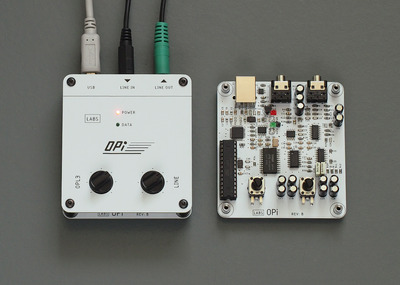

This is a new design I've been working on for quite some time.
OPi is an external USB sound device that allows games and other software running in DOSBox to use an original OPL3 chip for music playback. Additionally it has a line audio input for mixing PCM sound from a computer with OPL3 music and send it to a single line output of OPi. So when you play a DOSBox game - you hear everything from one output of the OPi (original OPL3 music + PCM sound) and both signals have separate volume controls. No need in external mixer. Thus, the device is also an external volume control for the computer's line out. The device is USB-powered. It requires USB 2.0 or better. USB 3.0 is faster (~15000 OPL3 packets per second vs ~6000 on USB 2), but at this moment only Descent feels the difference (as I remember it was also choking on P100+SB16 back in 1995) 😀
The project was started during countless lock-downs when it was impossible for me to access my old PC's, but a real OPL3 experience was needed 😀 Then it was on hold for some time due to the component shortage and now it is still in prototype state.

Actually the device is working fine, but it needs to become more mature and compatible. Currently lots of actions needed with the machine in order to prepare it for using the OPi. The device uses FTDI USB chip for communication with the host machine. So, an FTDI driver should be installed. A DLL with OPi API is already working - a DOSBox with OPi support uses it. At the moment it works only on Windows. The plans are to support Linux and macOS.
I'm open to any suggestions and ideas
I think that this is a compact and pretty idea and hope that maybe someone else could find it useful. If so - I will continue working on it, so it could be compatible with as much machines as possible, but only with mine 😉

sofakng wrote on 2022-10-31, 00:33:
Hi! Is this different from RetroWave OPL3 Express (previously the RetroWave OPL3) ?
DosBox-X already have support for it too...
Thanks for the info, didn't know about it.. I made a research about something similar when started the OPi and there was no such thing
Strange that it looks ridiculously similar indeed, but it lacks line input as I understand
At least now it became clear that OPi is not something new

Reply 16 of 16, by LABS
640K!enough wrote on 2022-11-02, 03:25:
I'm always interested in such efforts. Money to actually buy the finished product, on the other hand, is an entirely different […]
LABS wrote on 2022-10-30, 22:58:
Nothing at all? 😁
Did not expect such lack of interest
Or did I miss something?
I'm always interested in such efforts. Money to actually buy the finished product, on the other hand, is an entirely different matter. 😁
So, some (hopefully helpful) questions:
  1. Do you have a command that allows you to issue a reset, eventually asserting IC# on the OPL3? With the number of sloppy timing routines out there, and the fact that this is now being done over USB, that will likely be a handy feature at some point. Of course, since it is a USB device, another solution could just be to unplug the device briefly, but I always prefer an elegant method of resetting a device, and the number of sound cards that don't have one is surprising.
  2. Are you planning to include the connected sound card's output in an eventual S/PDIF signal? Have you chosen an ADC for that purpose yet?
  3. If you want to keep the OPL3 signal fully digital, rather than OPL3-DAC-ADC-encoder-S/PDIF, wouldn't you be better off with a YMF289?
Hi, 640K!enough!
Thanks for your interest
1) Yes, there is an OPL3 reset command of cause. The opifm.dll library provides API for controlling OPi. It also allows sending OPL3 commands by one or to form a command queue and send it as a packet (used for sending commands that should happen at once like a single row of events in Adlib Tracker). OPi also upgrades firmware over USB. Here is a header for opifm.dll with API commands at the end:

2-3) I'm thinking of S/PDIF out, but for the mixed analog signal (OPL3 + line) only. Just received UDA1355H, it has ADC and DAC with S/PDIF in both paths. Actually I'm going to try it for stereo version of Blasterboard and to convert CD-ROM digital out to analog and then to send all mixed analog sources together to S/PDIF via its ADC. Never worked with S/PDIF before, will see.
