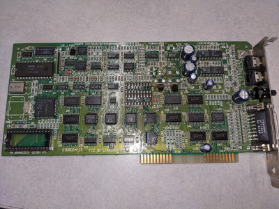

After years of reading through this invaluable forum, I finally worked up the nerve to ask for help on one of my personal projects that actually hasn't already been covered (I hope).
I have an ATI Stereo F/X ISA 8-bit sound card that is in need of resurrection. I received it missing its 28-pin DIP ROM and also ALL of its tantalum SMD capacitors. I think I've found enough pictures of the card online to identify the caps; however, I cannot determine whether the ROM is an EPROM or EEPROM (or possible something different). Knowing the part number of the ROM would be extremely helpful. I think I've found the 32kb .bin file that I'll need to program it, but I'm unsure and want to see if anyone here was willing to assist.
I think the tantalum caps are as follows. Please verify if you own this card.
(10) 16V 22uF 2719
(1) 25V 22uF 2719
(4) 16V 10uF 2312
(5) 16V 1uF 1206
Just need to know what the 28-pin DIP ROM chip is and maybe a dump of its contents if possible.
Its not a very common card, so hopefully someone here actually has one to compare this to. Fingers crossed. Appreciate any and all help.

Reply 1 of 21, by Tiido
It definitely will be an EPROM, flash chips were not common then and especially not for something that was never changing such as program code. 27C256 is the most likely candidate especially since you say the dump you have is 32KB.

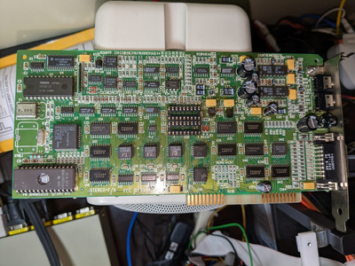

It's ALIVE!!! All seems to be working well in the limited testing I did this morning before work. Last night, I was extremely disappointed when no sound was being produced and I thought there was no hope for this card. While sleeping, I had an epiphany and remembered that the 486 board I was using for testing had issues in the past with a CT2910 sound card (which worked in another setup). So I swapped to a 386 board and...there was joy! The SFX test program produced sound and there was music in Monkey Island 2 and Descent! Will test Game Blaster functionality later tonight, but I'm pretty sure it will work since I tried it on the other board and didn't receive any errors; just no sound. Looks like another piece of history has been saved from the landfills!

You do need SAA1099 chips in the empty sockets for GameBlaster fun, and you should tape up the EPROM window.
Reply 12 of 21, by baracoota
I do actually have the SAA1099 chips and had them installed last night while testing. They were set aside for a QuickShot Sound Machine QS803 (SB 2.0 clone) board that is also in need of a small repair, but looks like they will now live in this Stereo F/X card. I didn't have them in for the picture.

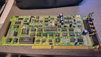

Sorry for hijacking this thread, but i have similar problem.
I have a bit different card, Ati stereo FX CD (sadly no gameblaster chip sockets) but problem is similar. Card is dead and the paper sticker on eeprom was burned on centre. So i guess on schematic must be a short circuit somewhere (usually eeprom chips wont generate much heat)?
Or could i just buy new eeprom and replace it, fingers crossed? 😀

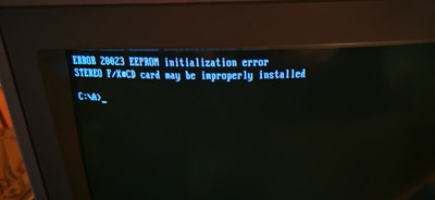

Hello everyone,
I also have a problem with the EEProm on my ATI Stereo F/X CD. The card is not found and when you run Install.bat an error message appears (similar to EEProm error, possibly card not installed correctly).
I have already tested it in another PC.
Does anyone have a BIOS dump from the Stereo F/X CD or can I use the “normal” one?

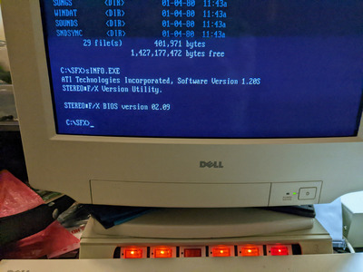

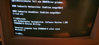

Update:
I have now programmed the BIOS of the normal Stereo F/X on another M27C256. This didn't change the behavior of the card.
I've attached a screenshot where you can see what SINFO spits out. The same message also appears if there is no card in the PC. I also read the bios of my card and uploaded it here. Maybe someone can look over it. It's also 32kb in size, but I have no idea if it has any errors.
Now assuming the bios IC is OK, what is stopping the card from booting? Basically the IC depends on the 8-bit ISA address bus. But the conductor lines don't go directly to it. It could be that a shift register (or similar) comes afterwards.
Is it that simple? EEProm OK+Voltage OK+Shift register OK=BIOS can be read
