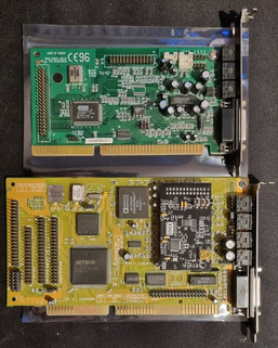

A photo of the card would be good.

See photo below of the 2 sound cards which I tried and have the same problem. Using the Aztech atm and yes the WT is absolutely correctly connected.
I tried to use those settings before but the /w:15 makes the non midi sound to hard and didn't do anything for the midi sound. Also the /l:15 didn't make a difference. Like I said in the opening post I even connected the WT out to the line-in (with a 3.5 connecter) and set it to /l:15 but even then the output the same (so very low).

Can you post photos of the X2GS front and back? If it works as a USB device but not on the waveblaster header for two different cards then it could be an issue with the connector or a trace leading up to it.
Have you tried the sound cards on a different motherboard btw? Just in case..

See below. But it's very difficult to see the traces even with good lighting. Also I tested with another X2GS (which @dreamblaster sent to test) which had the same problem.
Didn't test yet with another computer. Can't lift heavy objects atm so that will need to wait.
