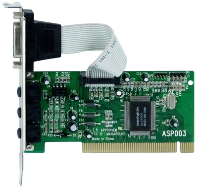

Can you please recommend a sound card with proper native DOS support ?
I found the ASOUND ASP003 MA5ASOUND ALS4000 PCI MIDI for a good price I play games like DukeNukem3D, Shadow Warrior, Blood, Screamer Rally etc
https://i.ebayimg.com/images/g/I~QAAOSwe89hvEub/s-l1600.jpg
Thank you
Reply 1 of 16, by Pierre32
Seems like you found one. I've read they're pretty good, but may be fussy about chipset. https://www.youtube.com/watch?v=lANmRgIHfw0
Also, Yamaha YMF724 / 744, and ESS Solo-1.
Reply 2 of 16, by mattw
maybe ESS Solo-1 is the most compatible of those options, because of its TDMA (Transparent DMA) support, I am not sure, just guessing. actually, if true, that should apply to all ESS chipsets, as I believe they all support TDMA.

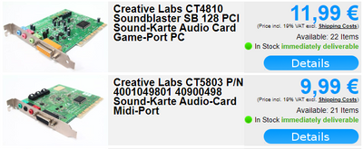

Reply 5 of 16, by Biomecanoid
What about these :
* Creative Labs CT4810 Soundblaster SB 128 PCI Sound-Karte Audio Card Game-Port PC
* Creative Labs CT5803 P/N 4001049801 40900498 Sound-Karte Audio-Card Midi-Port
Reply 7 of 16, by Biomecanoid
Pierre32 wrote on 2023-05-08, 12:34:
They don't have OPL (or a good OPL clone like the ALS & ESS do) so they won't sound good in DOS.
At this point because these thingz slowly become VINTAGE and rare I will be content with anything that works.
Will those work ? I am more worried about compatibility than sound quality
Reply 8 of 16, by Pierre32
They'll work. They are consistently the cheapest vintage sound cards on the market, because they exist in great numbers and no one really wants them. If you want to lock one into your collection then fair enough. Just know that they are nobody's go-to card for DOS gaming.

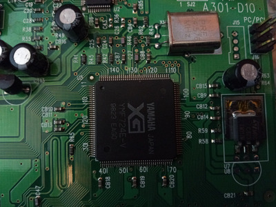

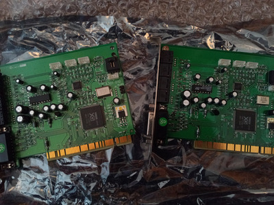

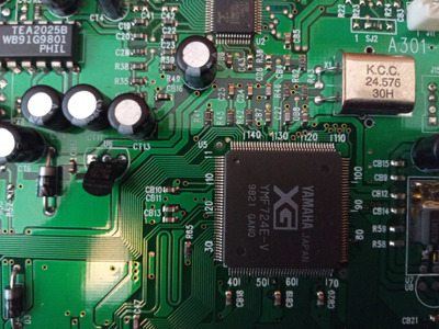

Reply 10 of 16, by Biomecanoid
Now I scarped the bottom of my storage room and found what I managed to "save" from moving houses a few years back.
I guess these are the Yamaha cards you are talking about right ?
It seemed that I knew what I was doing back then pity I had to move and throw away lots of stuff 🙁
Reply 11 of 16, by chinny22
Looks good to me!
For what its worth I don't actually mind the Creative cards you listed. It uses the same driver therefore the same compatibility as a Live/Audigy in dos however lack EAX when in Windows.
That said the Yamaha is a far better card. True OPL for Dos and that XG Midi chip basically gives you a MU-10 external Midi module
