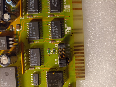

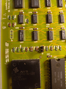

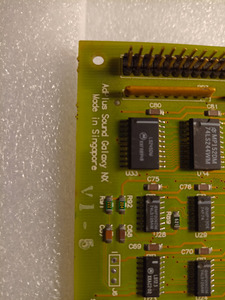

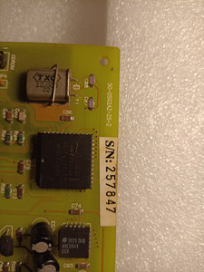

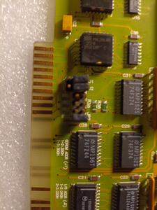

I recently saw a relatively inexpensive 8-bit sound card from Aztech Labs and couldn't resist. Unfortunately I can't manage to install it in a Commodore PC20-III. The card itself seems to work, at least it plays the utility program fmradio.exe-file without problems (found here on vogons). Possibly it is an IRQ conflict, but I don't know how to fix it. I saw with Checkit! that IRQ5 is occupied by the hard disk and IRQ7 by the printer output. The card itself is jumpered to IRQ7 and D220 (really?) by default (see attached photos), however I am not clear where exactly the 1-2-3 pins are). The computer is a XT and has no Bios, so I wouldn't know how to disable eventually the LPT port, which I don't need. Or are there other solutions? Strangely enough, the computer detected the "game port" the first time I turned it on, but then subsequently did not. Does this also indicate an IRQ conflict? There is no software for the card, only for the successor card NXII (always here on Vogons). This softwarefor the NXII might also be compatible with the older NX, but is on 3.5 inch disks, which don't fit to the PC20-III with its 360 Kbyte drive anyway. I'm not getting anywhere with it for now. Greetings from Rome!
Reply 1 of 23, by dionb
Resources on an XT are always fun. You only have a few IRQs and DMAs to play with.
You can choose between IRQ 2, 3 5 or 7.
Their normal allocation:
2: EGA/VGA (not always used)
3: COM2
5: HDD controller
7: Parallel port
Depending on what you use, I'd suggest using IRQ 3 or 7. IRQ2 might work, depending on your video card, but is not always selectable in games, so I'd only try that if absolutely can't get IRQ 3 or 7 working.
That means you need to disable either second serial port or parallel port. You say an XT "has no Bios". That's incorrect, every PC compatible has a BIOS. An XT just doesn't have an interactive setup program for it. Moreover, ports are configured in hardware with jumpers. You'd need to disable COM2 or LPT1 on the I/O controller, which I believe is integrated into the motherboard on this model.
Same for the card: no software involved, you just configure with jumpers. A220h I7 is the default for sound cards on XT, so nothing strange there. A220h should never really be a problem - and the fact fmradio.exe plays shows that you're able to access the OPL2 for FM synth, you just need to find a free IRQ for SB DA.
Now, challenge is that I'm unable to find jumper manuals for that Commodore system, but somewhere there needs to be a set of jumpers for I/O. Failing that, try IRQ2 after all.

Use IO 220h, IRQ 7, DMA 1.
No need to disable the LPT:
- if there's nothing connected, it won't generate interrupts
- if there's a printer, it's operated in polling mode - again, no interrupts
And remember to add this to AUTOEXEC.BAT:
set BLASTER=A220 I7 D1
