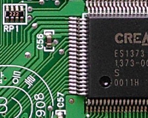

I have an old computer with an Intel Intel 945G ICH7 chipset and I recently got a Creative CT4810 PCI card, for which I can't find any working drivers (I'm mainly looking for win98/dos drivers)
I tried a lot of drivers, read similar topics, but without success.
The pictures show exactly my card with the most important data on it.
What is particularly interesting is the product ID:
PCI\VEN_1274&DEV_1880&SUBSYS_20001274&REV_02
PCI\VEN_1274&DEV&1880&CC_040100
I thought it should be 5880 according to the mark on the chip, but with this , google gives me only a couple of entries and none of the drivers I found would work.
The closest thing I've seen is the problem on this topic, but I can't seem to solve it.
CT4810 / CT4830 PCI Sound Cards trouble - CT4810 CT5880 Win 95 DOS drivers - Solved
I have a fresh install of win xp and win 98se, on board sound is disabled, no conflicts, just don't have valid drivers.
Please help!

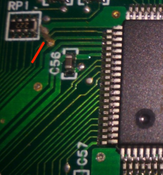

That solder blob does not look right. I have a similar CT4810 card but with the ES1373 audio controller chip. The card layout is similar and the solder point on mine does not bridge several traces.
Another point is your PCI vendor/device ID of 1274/1880, as you guessed correctly it should be 1274/5880, as though one bit is not set when it should be. Looking at the entry for Ensoniq in the PCI device repository, there is indeed no device 1880 butunderdevice 5880, there is an entry for subsystem vendor device of 1274/2000 which matches the CT4810.
With the incorrect device ID, drivers will not match and simply won't work so it's worth cleaning up that solder blob to see if it changes to the correct one.
Some years ago, I had a similar issue with an ESS Solo-1 ES1938 (those "new" PCBs with recycled chips) whose PCI ID should be 125d/1969 but it came up as 125d/1869 and naturally didn't work. I simply removed and reinserted it into the PCI slot and luckily that fixed it, and it has remained fixed ever since.
Reply 12 of 20, by retrofan011
andre_6 wrote on 2023-05-30, 21:17:
Success at last, my friends!
I decided to sublimate all the good advice from here and give it another try.
I took the card out again, cleaned it more thoroughly with eraser, put it back in and the Vendor ID correctly recognized the number as 5880!
After that I started trying out the drivers.
WInXP driver was installed plug&play, but for win98 I managed to install manually CT5880_9X - MAIN DRIVERS from @andre_6 attachment.
During the installation, it asked me for three files EAPCI2M, EAPCI4M and EAPCI8M to complete process, which I found in the AudioPCI folder.
All the other drivers I had wouldn't work (BSOD) and this one only installed when I set the PCI IRQ to 11, i dont know why.
After installation, it also works fine on other IRQs that are free (10,9,7,5).

Success at last, my friends! I decided to sublimate all the good advice from here and give it another try. I took the card out a […]

retrofan011 wrote on 2023-05-31, 16:06:
Nice work. Is the solder blob still there? I'd try to clean that off as well, it just doesn't look right (if it is a solder blob).

jtchip wrote on 2023-06-01, 00:02:
Not sure if it was a solder blob, more like dirt, looks a lot better now.
