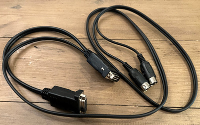

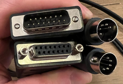

keropi wrote on 2023-08-07, 22:38:
I suspect a gameport->midi cable problem, what do you use for this?
Here's a look at the cable. It came still sealed in a bag that seemed legit. I bought it on eBay from someone who said it was new old stock, but I guess it's hard to know for sure.
The attachment midi1.JPEG is no longer available
The attachment midi2.JPEG is no longer available
If this is the problem, does it make any sense that it would work just fine on my PCI sound cards? That felt like a good reason to cross it off the potential suspect list, but I fully admit I don't know much about the inner workings of these things.

Reply 6 of 16, by keropi
maybe your gameport->midi cable is just straight wire connections without any components in between - it would explain why older cards have issues with it
sadly you cannot easily check since it's molded type of cable... several components are needed inside the cable to make it work reliably as shown here: http://midi.teragonaudio.com/hardware/pc_intfc.htm
I am sure that if you can test with something like a DB15MIDI things would work just fine.

Reply 8 of 16, by danieljm
I reminded myself in another thread that I should post a conclusion to this. I ended up ordering the DB15MIDI and all my ISA cards seem to work great with it. It would seem that the cable was the problem.
Thanks everyone for your advice. Cheers.
