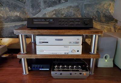

Right now I use two things for switching and mixing audio:
1. Roland (Edirol) M-10MX mixer for audio sources I want to combine
2. RCA switch boxes for when I want to switch between audio sources
I have it wired so MIDI modules go into the switch box, then the output goes into the mixer along with any sound cards.
This allows me to toggle which MIDI device I want to hear, plus mix any digital sound from the sound cards with the MIDI audio.
I've also used the unpowered (passive) versions of the Rolls mini-mixers. They're decent, but the unpowered ones do suffer from a bit of volume loss. I imagine the powered version mentioned above probably mitigates that issue.

Reply 4 of 7, by ubertrout
Do you find there's any issue of hum or static with the mini-mixers? My speaker setup is plenty loud I find, but I want clarity.
...or at least no further degradation of the sometimes questionable audio we got from old sound cards.

Reply 6 of 7, by Shponglefan
ubertrout wrote on 2023-11-21, 04:41:
I haven't noticed any significant change in audio, at least not compared to the source audio to begin with.
The only thing is that with unpowered mixers there is some volume loss.
