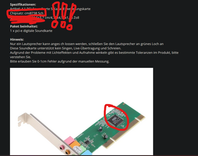

Reply 13 of 22, by DerBaum
maxtherabbit wrote on 2024-01-06, 16:02:
songoffall wrote on 2023-12-06, 11:27:
So there's these Chinese sound cards that cost peanuts, using reclaimed Yamaha XG, ESS Solo-1 and other chips. But they seem to be extremely barebones, with sub-par or missing components and features.
where can I find a chinese solo-1 card for peanuts? ebay searches coming up empty
you can find soundcards showing ess or yamaha chips ... but they all have cmi chips if you really read the text... (like its normal from chinese sellers)...
The times you can get cheap yamaha or ess cards are over.

Reply 14 of 22, by songoffall
DerBaum wrote on 2024-01-06, 16:12:
you can find soundcards showing ess or yamaha chips ... but they all have cmi chips if you really read the text... (like its nor […]
That's not entirely correct. It's more like a lottery. Some cards are true Yamaha and ESS cards. Some are CMI chips repainted as Yamaha and ESS chips. I have both a Yamaha XG and ESS Solo-1 copy, both have been tested with their corresponding drivers. The Yamaha one can be identified by the presence of an additional codec chip on the board. I made a topic on it:

Reply 15 of 22, by songoffall
They are on Aliexpress and the like. You can never be sure if you're getting a true ESS card. If you really want one, I can gift you one of mine.
