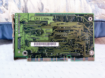

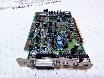

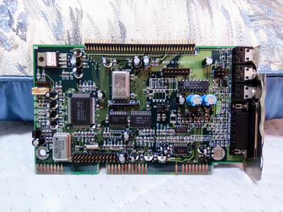

Today I dug out the pile of sound cards under the bed. They have been there for almost twenty years.It feels like I'm 30 years old again 😀
I find a card that's a bit special. I can't find the brand, and there's an interface I don't recognize on the top of it, with 40 pins - what is it used to connect to?

Reply 1 of 7, by Tiido
What a strange thing indeed !
It looks like the top connector has a lot of signals from the ISA side connected to it, but what is it really for I wouldn't know...

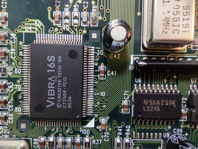

Reply 3 of 7, by DerBaum
I have seen similar weird sound cards based on the vibra16s.
For example this thing:
It is for a siemens nixdorf FD210 All in one system.
Judging from the strange bracket on your card, it seems it came from a special application / integrated system.

Reply 4 of 7, by qdsong88@
DerBaum wrote on 2024-01-19, 02:51:
I have seen similar weird sound cards based on the vibra16s. For example this thing: https://i.ebayimg.com/images/g/xm8AAOSwKwlk […]
This one is indeed weirder

Reply 5 of 7, by gdjacobs
All that via stitching is impressive. Someone was serious about suppressing stray voltages.
Reply 6 of 7, by JidaiGeki
qdsong88@ wrote on 2024-01-19, 02:09:
Even stranger, that’s 80 pins… The numbers on the card look like Acer part codes but Google doesn’t turn up anything.
Reply 7 of 7, by qdsong88@
JidaiGeki wrote on 2024-01-20, 04:30:
I took it out and checked again,It is indeed 80 pins.
