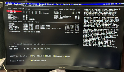

Reply 4 of 8, by insanitor
Tiido wrote on 2024-02-06, 18:06:
You can try SETYMF too : Re: T-04YBSC-A, new YMF71x based sound card + SETYMF utility
If might give some new info, but it is starting to look like there may be some fundamental incompatibility.
I ran the program but I have some difficulty deciphering the output.
EDIT: I installed the driver but I got the same exact problem with the speakers.
I’m beginning to think that this behavior is normal for this card because this card is not normal.

Reply 5 of 8, by Tiido
It shows all the current settings for IO, IRQ and DMA resources. You can press the letters/numbers marked in yellow color to do a sound test, if these tests fail you change some of the settings to rule out any possible IRQ conflicts etc.
If there are error messages of any sort, those should be written here for any further thoughts. I suggest to read the text files for more info.
(I see I have a little error, the Covox bit should be hidden on the generic YMF71x cards)

Reply 7 of 8, by Tiido
Do you have photos of the card ? It might have some actual damage on it, or perhaps all its problems are from some bad capacitors.
The DSP version is for the SB side, the YMF71x chipset lets you choose which SB version it reports and games that use it, can set capability according to that number.
