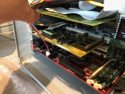

I love how the yellow Multimedia Pro 16 IIB-3D looks against the red Gravis.
Now time to finish 486 DX4-100 with 7 sound cards 😉
