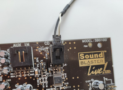

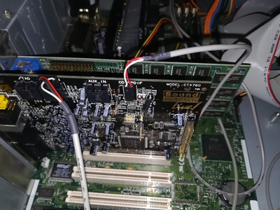

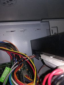

Hi,
I'm trying to get digital CD audio working in Windows 98SE. The option in the multimedia settings is always greyed out., and it's always using the analogue output. I have a Sony DDU220E with a Sound Blaster Live! CT4760. The SPDIF cable fits both ways, and I don't know which way around it is supposed to go in; the DVD drive manual says pin 1 is Digital Out and pin 2 is Ground, but doesn't say which is which, and the sound card manual gives no information at all about which way around it goes. The reason I'm doing this is that I'm getting hissing from the CD audio, even if nothing is playing, and I don't know what else to do. Am I doing something wrong? Thanks.

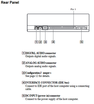

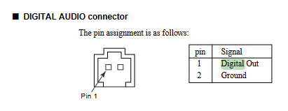

Well, I just get silence when I play CD audio when the analogue source is muted. Attached are some quotes from the manual about the drive's audio output, and a screenshot of my mixer settings. It looks to me like the drive does support digital output, yet I just cannot get it to work.

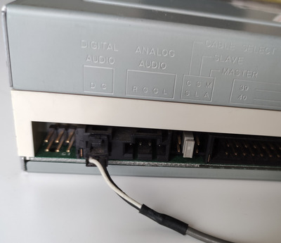

Here's a picture of my digital CD audio cable. It's the original version that Creative used to ship with their SBLive and Audigy cards. Notice the plastic tabs which act as a key for the connectors:
104.97 KiB
533 views
And here's how it attaches to my DVD drive and SBLive card:
128.65 KiB
533 views
222.81 KiB
533 views

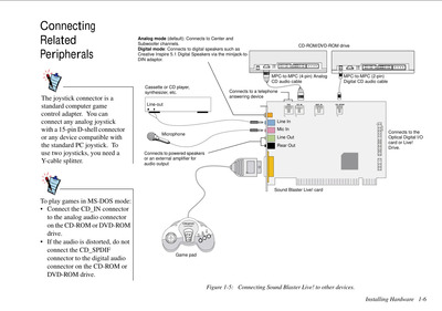

As mentioned earlier, on my setup, pin 1 of the SBLive's CD_SPDIF header gets connected to the "G" pin on my DVD drive. The cable cannot fit any other way. And lastly, here's the relevant page from the SBLive manual:
189.95 KiB
533 views
For me, this just works. Meaning, when the cable is connected and the CD Digital volume slider is unmuted, I get crystal clear digital CD audio on that card. This is with VxD drivers installed, and no other settings changed.

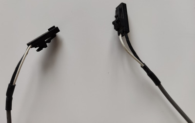

I don't have a Creative cable; I just have this generic one: https://www.ebay.co.uk/itm/372606655766
As you can see from my photo in the first post, mine has a white wire and a red wire. No black wire. Do I have the wrong cable? Mine also has no clips, and the sound card has no plastic cover over the SPDIF pins.
Assuming the white wire on my cable is the same as the one on yours, I switched the wires to the position you have them, but I still get silence.
