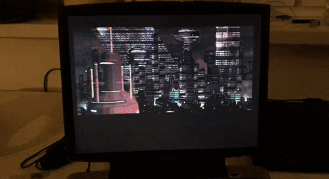

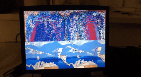

Long story short, I've got two units of Toshiba 5205, one with Geforce 460go and another one with Geforce FX 5600Go. The first one produces an abnormal amount of glitches in DOS games under Windows 98, FX one runs most of my stuff perfectly, but still few titles struggle to show some parts. I assume these parts have something common and fixing one will fix other games too.
Sea Legends (1995), shows FMV intro, no issues, then main menu, no issues, but sea sequence are messed up, also later FMV sequences are messed up:
System Shock (CD), intro video is okay, gameplay is okay, but the main menu is crippled:

As I understand, video mode changing in Windows works somehow differently from native DOS, and when games have different video modes for different parts this breaks the game.

Reply 1 of 1, by vorob
Case solved, I've downgraded from 77.72 to 45.23 and DOS games are okay now.
