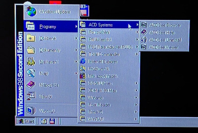

As this is thread with the most extensive knowledge about VGA quality related issues I will ask here. I have problems with what you would probably call "ringing". My setup is GeForce 4 MX440, VGA cable and monitor AOC Q3279VWFD8. As you can see I have quite big problems with white shadowing around letters in horizontal direction. I'd say it's more or less visible on every object, but especially on black letters on gray background:
131.11 KiB
2329 views
In the beginning I thought this must be cable related issue, so I went and gathered several VGA cables (some of them really thick with impedance = 75 Ω), but with no luck in improving the situation. I have also tried different graphics cards, again without success. Then I tried a different LCD (FSC P19-2) and suddenly the issue was gone (even with the cheapest of the VGA cables). Conclusion is that this AOC monitor has probably poor VGA input quality (maybe insufficient shielding or something like that), but since it has another pros (low input lag, extensive scaling options, no frame-skipping for 70 Hz) I would very much like to use it for retro computing purposes (that's why I insist also on VGA for better DOS support). The question is: Is there something that can be done with the VGA signal so that it will not manifest aforementioned issue? Some kind of active/passive adapter that can improve or tweak signal parameters?
Reply 1130 of 1405, by darry
elcrys wrote on 2021-12-21, 18:59:
To my eyes, these look more like over-sharpening artefacts . I presume you've already tried auto-config to no avail . Have you tried lowering the sharpness setting ? Also, If that AOC monitor displays correctly when fed through DVI or HDMI, you might want to consider an external digital like an OSSC to convert the analogue VGA output from your card to DVI/HDMI .
Note that the sharpness setting might be per input or global and over-sharpening is likely to be a lot less noticeable the higher the source's resolution .
Reply 1131 of 1405, by elcrys
Sharpness setting is something definitely worth checking out. Although as I have experienced in the past, the effect of oversharpening was much more subtle (more like a corona around objects). The effect in the picture is huge (several pixels) and the shadows are going strictly in horizontal direction.
Yes I've tried auto-setting, the resolution in Windows is 1280x720 (for correct aspect ratio) and the effect is more visible on 1:1 setting.
OSSC can be a solution, but I guess it can bring some other problems. I'm not sure if it can process all types of DOS inputs without constant tweaking. VGA is quite straightforward in this. Yes, this AOC can handle DVI/DP/HDMI inputs without any problems.
I will check the sharpness once I get home.

Reply 1133 of 1405, by elcrys
darry wrote on 2021-12-23, 03:24:
Thanks, it looks like you were right. Unfortunately setting for sharpness is quite non-linear with this AOC: There is barely difference between "100" (the highest sharpness) and "50" where white "shadowing" is still visible, then there is a big step on "40" where all the "shadowing" disappears, but at the same time everything gets blurry and then there are gradual steps of blurriness to "0". Originally I had "100" so I set "50" and it's better.
Good thing is that these artefacts are non-proportional - this means the amount is always approx. 2 pixels around objects on every scaling setting (from 1:1 to full-screen). This would indicate the issue is not the signal itself but more likely the processing. For low-res DOS games with non-native resolution the artefacts are hard to spot. The issue is visible only on 1:1 scaling setting, which I am not planning to use, so I can live with this. In this case I can also set sharpness on "40" as the additional softness is not so visible on 1:1 scaling.
