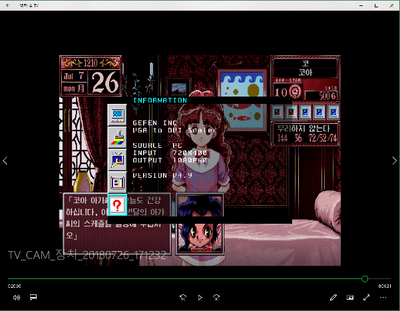

I recently tackled this problem with help from all the great information in this thread. The solution that works for me is a Gefen VGA to DVI Plus with a DVI to HDMI cable going directly into my Samsung 4K TV. I get all modes: BIOS, DOS, VESA, and Windows 3.1 with both SVGA and S3 Trio 64 drivers. The only caveat is that the Gefen output is vastly superior at 720P when compared to either 480P or 1080P. I suspect this has to do with some disharmony between the Gefen's scaler and the Samsung's scaler.

Reply 537 of 1299, by ik777
Very, very happy.
Gefen should do that, I also recently bought them cheaply. Since portta scaler is less than 10 bucks, it should be more cheaper.
Please do not advertise this one's capable of 720*400 so price got lower. (I think ebay things are from school.)
But Phil will advertise it... 🤣 🤣

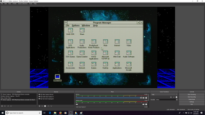

Reply 539 of 1299, by creepingnet
I use a cheap and crappy setup I put together for about $1.99, it does the job though.
The main capture device is a VIDBOX HT USB DV Capture box. It only does composite or S-VIDEO, works okay with the Tandy 1000 (though I'd probably get best quality with a monitor attached)
The second capture device is what I use to convert my VGA Signal into a Composite signal, this is a "PC to VIDEO EZ" box. It works alright. I've also used to to run my VGA machines into an older CRT TV or a TV without VGA inputs.
I use Open Broadcaster Studio for capturing the footage, and I use OpenShot Video Editor to edit the video captured and piece it together for youtube.
The computer I'm using for all this is a Core 2 Duo 3.0 GHz with 6GB of RAM and Windows 10, with a 512GB SSD and a 1TB SATA HDD. I eventually plan to upgrade it sometime in the next year or so when I can afford a new CPU/MOBO/RAM setup for it in mATX format. It does the job but it has been a little more sluggish lately. There is also a little latency between what is actually on-screen on the PC being captured and what is on-screen on that actual device (if I'm not using the capture monitor on my main PC to see what I'm doing). It can't be too bad though - made it to Night 5 on FIve Nights at Freddy's using my old crappy Win7 Toshiba with this setup without dying once so the latency is a non-issue for 90% of what I'm doing.
Here's a a screenshot of my 486 DX4-100 running Windows For Workgroups 3.11 from just a few seconds ago
