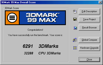

Just ran this on my "Ultimate late '98 system"
Pentium II 450
256Mb 100Mhz SDRAM
Diamond Viper V550 (nVidia Riva TNT)
Windows 98SE
I think it did alright

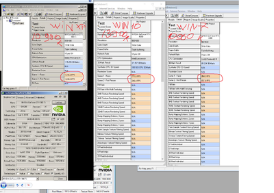

Thanks a lot. Finally a patch that counts FPS. Until this one i always had like 0 to 1 fps counts during the benchmark. Although the results are way lower than they are on windows xp and windows 7
I've attached a screenshot with 33mark99 results from left to right: Windows XP + 10900k @ 5700mhz CPU (6 cores active no HT) , Windows 10 + 13900 @ 6300mhz (6 P cores no E cores no HT), Windows 7 + 10900k @ 5700mhz (6 cores active no HT) .
Although 13900k at 6300mhz is much more powerfull than 10900k at 5700mhz, the FPS is much lower. I would love to try 13900k with Windows 7, but there's no VGA driver for RTX 4090 and Windows 7.

Yes, that's a different issue. If you look at "CPU optimization", it says "Intel Processor" with the 13900K.
However, with the 10900K on Windows XP & 7, it says "Intel Pentium III". This most likely means that it's unable to detect and properly use the SSE instructions with the 13900K, which is also the case with many other modern (and not so modern) CPUs. I don't think it's OS related, because this also happens on Windows 98 with certain CPUs like the VIA C3 Nehemiah.
PS: awesome work, @mkarcher! 😀
